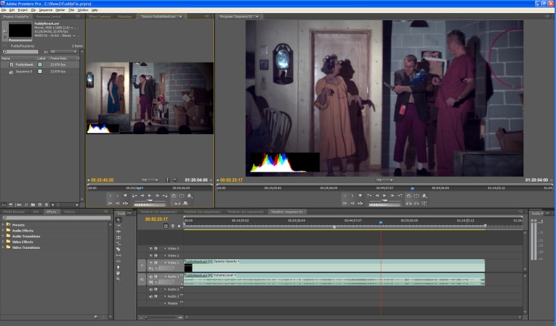

I have a couple of issues with the FL histogram with ProspectHD. First, the histogram doesn't display correctly unless I put in some offset in framing (just 0.01 will do it). Otherwise the displayed histogram shows just a small amount of the information toward the dark end.
The second issue is that the histogram won't display in CS4, and it kills CS4 if I try to use it. I don't know whether or not the histogram is supposed to play in the editor - it would be nice. The histogram plays in my other viewers, albiet slowly.
Histograms are tricky beasts, they often don't display much if the data is skewed with a lot of saturated blacks or whites.
Sorry about the CS4, no one reported that in the beta :(. However, I don't see it here, not issue, histogram is working, so please submit a trouble ticket with support.
