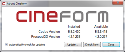

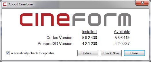

Installed the ProspectHD the version downloaded from the link above (over the one installed) ... and the tray utility - shows the old version 4.2.0.237 and the HDLink 4.2.1.238.
Is this what is supposed to do?

it should report new components when running the beta. If not close all video tools and reinstall.

Mine did the same until I rebooted. I just assumed it was because I installed over the top of the other....
