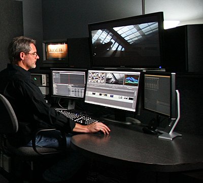

If I bought two cheapo video cards, would I be able to output to two monitors from one card and the video overlay to an output on the second card?
Hi Ben,
I run a system with four displays with CS3/4/now 5 with two Quadro cards in the system...four heads.
TimK

Originally Posted by Tim Kolb View Post
Hi Ben,
Now thats a setup! Wow well done!
