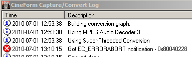

Hi
Any idea what causes this error
See attachment
Gil

I'm having the exact same issues with converting Panasonic's AG-HMC150 AVCHD files...!!

I have reproduced this issue as well with HDV footage captured from a Sony HVR-V1U. I used both HDLink and Adobe CS5 to capture the footage off the tape and in both situations I get the error mentioned.

I got this reply from Cineform's support guy:
disable user account control in windows control panel and then download and install the 64-bit version of ac3filter from AC3Filter. during ac3filter installation, make sure to select both the 32-bit and 64-bit components.
then try converting your files again and it should work.
i'll try it later this night tho if it works

So I tried the fix in the previous post and it worked! All my footage converted fine.
