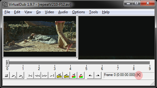

David, I have a question. I've been trying to find a quick tool that tells whether video we've done is I-frame only only or not. G-Spot shows nothing about it that I can tell, neither does VD or anything else.
We have a mixture of stock that is both ways and really need something that tells which way it is so we can re-convert whatever we are currently working on.
Any suggestions as to a quick (and free) tool that does it?

The only reason to worry about I-frame, is for 3D work, otherwise is it completely transparent all 99% of video applications. Use VirtualDub, is will mark I-frame with a 'K' (for Key frame) and P frames with nothing.

That's exactly what I was looking for and could find no info anywhere!
Tnx!

One more comment:
In VD, you have to "frame by frame advance" to see if it's I-frame only. If it is, every frame has the K. If not, every other frame has the K.
