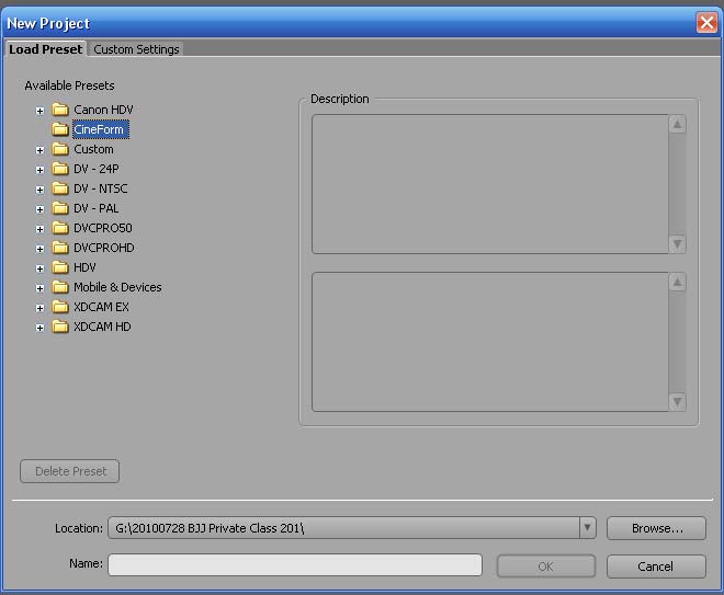

Where did the presets go?
I just did the upgrade to Neo HD, and the Project presets I used for earlier projects are no longer getting loaded into Premier Pro CS3. When I try to open a project I was working on a few weeks ago, I get the following error:
"The editing mode used by this project could not be loaded. The project will be opened in Desktop mode."
If I try to create a new project, Premier Pro CS3 does not see ANY of the Cineform presets, even though they are in the presets folder (C:\Program Files\Adobe\Adobe Premiere Pro CS3\Settings\en_US\CineForm). They are all listed as Prospect presets.
Julian Frost is offline   Reply With Quote
Old August 30th, 2010, 03:03 AM   #24
Location: France
Posts: 44
I have the same problem as you.
Under CS3, Cineform presets are no longer available.
I've checked the files and everything seems to be ok.
The workaround is to recreate manually my favorite preset in order to use Cinefrom projects again.
Cedric Pottier is offline   Reply With Quote

Old August 30th, 2010, 01:24 PM   #28
Location: France
Posts: 44
presets fixed now for CS3
I use a french version of Premiere Pro CS3.
The "Cineform" preset directory is only present on C:\Program Files (x86)\adobe\Adobe Premiere Pro CS3\Settings\en_us
If you copy "cineform" directory to C:\Program Files (x86)\adobe\Adobe Premiere Pro CS3\Settings\fr_FR
the presets are back again for new projects.
Regards.
Old August 30th, 2010, 01:47 PM   #29
Location: California USA
Posts: 576
Cedric,
That's a good work-around for those using CS3 on non-English Windows installations, but, unfortunately, it won't work for the rest of us!
It's a good catch... It shows that the installer is apparently not looking closely enough to see where it should be placing the presets (IE. disregarding the Windows language setting). One of the fixes in this latest release was to make sure it installed correctly on disks other than the C: drive.
