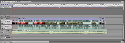

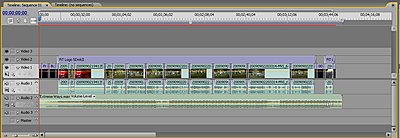

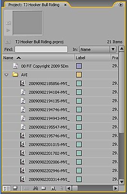

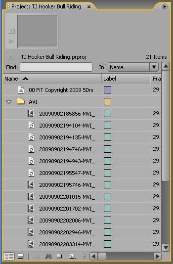

I uninstalled 268, searched for *CFHD*.prm in the Adobe folder (and sub-folders) and found the following files:
c:\Program Files\Adobe\Adobe Encore CS3\Plug-ins\en_US\im-CFHD_File_Import.prm
c:\Program Files\Adobe\Adobe Encore CS3\Plug-ins\en_US\Backup\im-CFHD_File_Import.prm
I deleted the files, and installed 271.
Same problem: Random AVI files are loaded as if they do not contain audio.
Attached are some screen shots. The first one is an existing project, as opened the first time. You will see there are 2 AVI files on the timeline which were not imported correctly.
I closed the project, and opened it again. As you can see in the second timeline, there are 6 AVI files which were not imported correctly!
I included a shot of the project window so you can see how PPro CS3 sees these files.
Again, this is the same project, opened once, closed, and then immediately opened again.
This random incorrect importing happens on every project I open.
