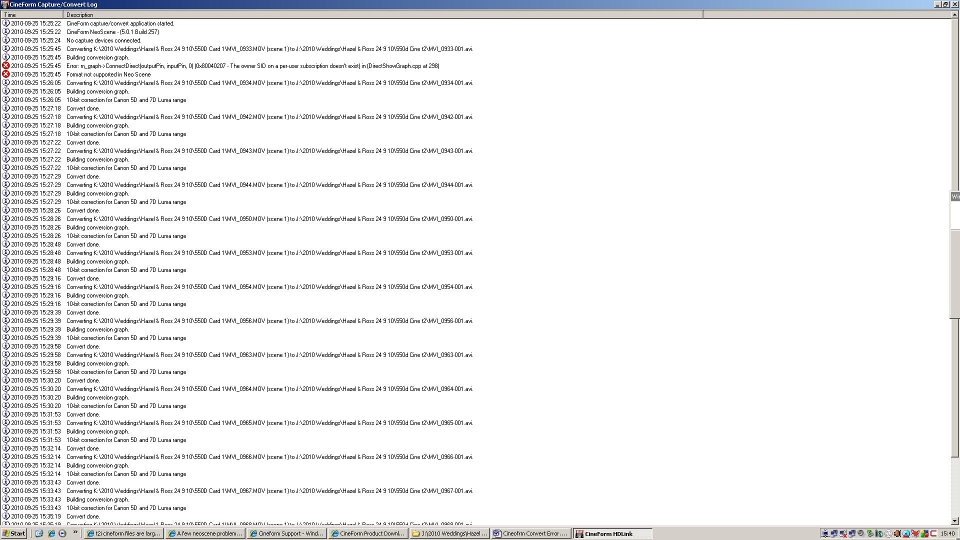

One of the same errors happened again, I took a screen grab (just using the 'prtscr' button + paint)

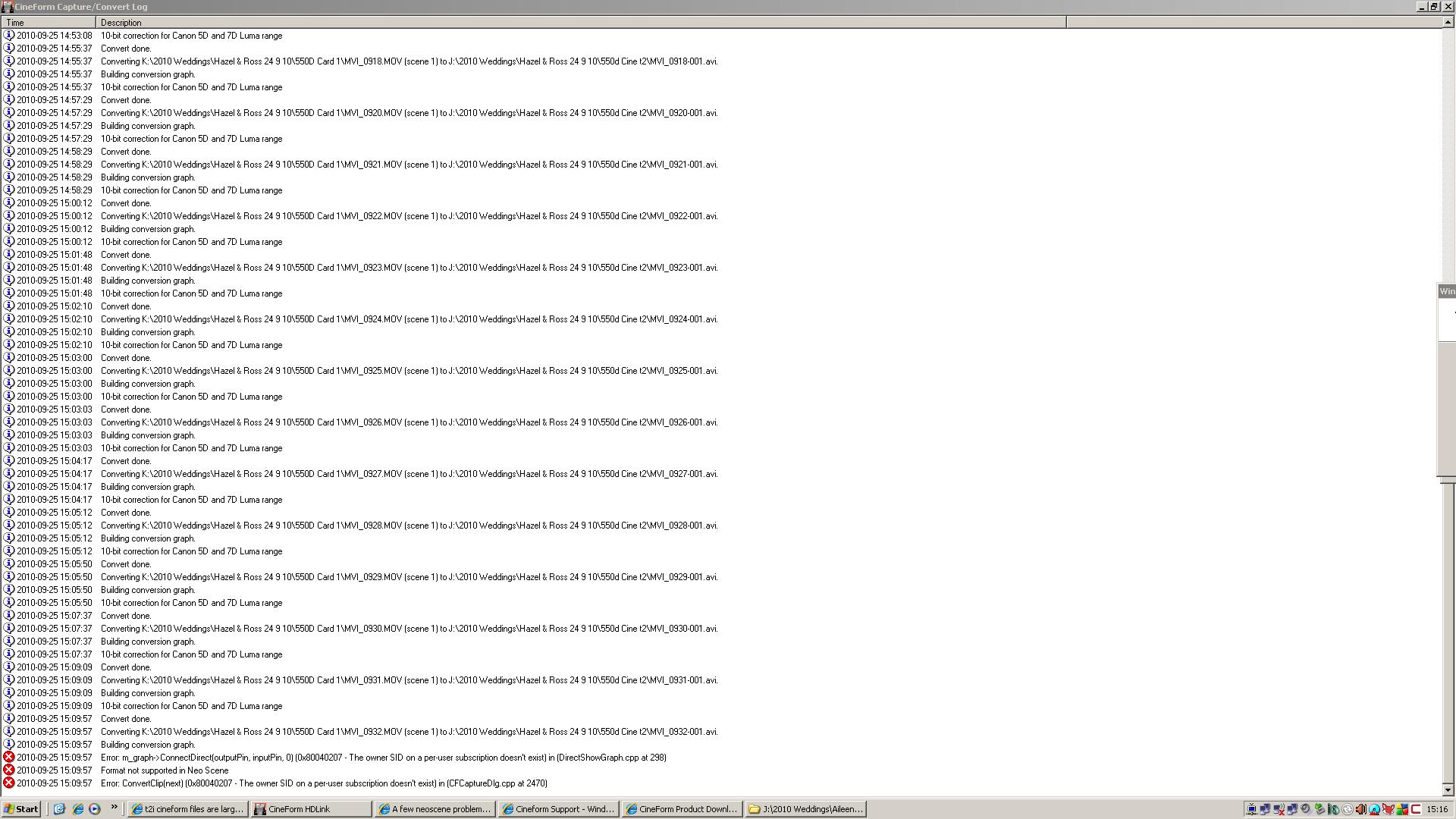

and again, (see attach screen grab)
These 2 files were right next to each other, is it more of an issue with the t2i and or the card (ie the files itself) rather than neoscene?
