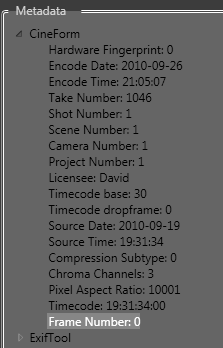

Add the overlay Unique, and see whether the waveform disappears at frame 100000 (or 1 hr 9 mins for 24fps sources.) If might a limitation that we need to fix.

I'm sorry but I don't understand what you mean by the overlay Unique.

Sorry that is the internal name. I meant frame number.

On one clip it disappears at frame 133472 and the other at frame 108745. What is common in both circumstances is that the burn in disappears the next frame after a Primary Correction keyframe (the last place it is visible is happens to be on a keyframe). Both clips are 1080 60i shot with two different Sony Cameras.
