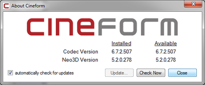

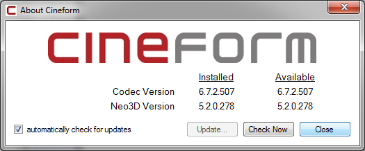

New releases for Mac and PC are out.
PC versions is at 5.2.0
Mac version is at 5.0.23
Download from cineform.com
Highlights form the PC release notes
* HDLink can now generate proxies
* more control of the Decoder for speed and 422 to 444 upsampling.
* more 3D control
* more CS5 integration for MOV files.
* enhancement to FirstLight and manual updates.
* Support for MXF 4:2:2 cameras like the Canon XF300 series (NeoHD and above.)
* lots of bug fixes.
Mac also gets many similar enhancements. Please try out the beta 5 version of FirstLight, this operates far more like the FirstLight addition on the PC. This will soon replace the old FirstLight on the Mac.
