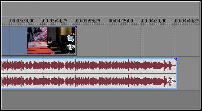

Looks like same old problem keep on coming back.
I did convert some older 5D2 files 30fps to CF AVI. Audio did not sync any more.
System is Vista 64 and Vegas Pro 10.

Easy to diagnose, are the clips flagged as 30.0 or 29.97fps? Do they play out of sync in mediaplayer, or is simple more samples in the audio than video? From the screen shot not much can be learned, other than look like the audio playing about 18% slower than the video, which is not an known bug (.1% is more typical for 29.97 vs 30 issues.) Please fill a trouble ticket with support.

At least Vegas Pro is showing original 30fps and CF avi 29.97fps.
But ok I can use original files instead CF. VP 10 will be now faster previewing original mov files. Propably CF files will be later as fast or faster playing with Vegas 10.

We convert to 29.97 as a default, as 30.0 is not commonly used. If you want 30.0 there is a option to turn that off, will written here somewhere on the forum or support can tell you.
