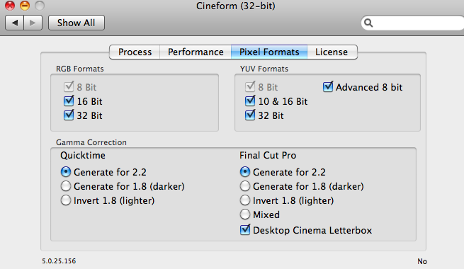

Old November 9th, 2010, 01:04 PM   #5
Location: toronto, canada
Posts: 212
image attached, what setting do I need to change?
8 bit is greyed out. (sorry for misunderstanding)
thank you!

Old November 9th, 2010, 03:44 PM   #6
Join Date: Oct 2007
Location: Estonia
Posts: 142
Hi
You are looking at the wrong page in control panel. The debayering settings are in the Process tab.
What is exactly You want to change?
Thank You
-Kaspar
