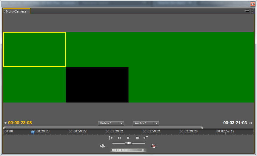

I sent a trouble ticket to support detailing the problems I'm having with CS 5.5 and CF AVI files in a nested sequence, for multi-camera use. Plain and simple, it doesn't work!
I sent in a VERY detailed message, and the VERY terse answer I got back from support said, simply, that it was Adobe's problem.
In a nutshell, when I use CF AVI files, nest them in a "DSLR 1080p" sequence, enable multi-camera mode on the new sequence, and show the multi-camera window, all I get is a green screen. I can click on where the individual cameras are supposed to be, and PPro CS 5.5 records the edits, but since the screen is completely green, I can't see what I'm editing! See attached image, showing the problem (with 3 cameras included in the nested multi-camera sequence).
I was told to set the sequences' editing mode "Desktop", but that's not an option in CS 5.5. So, instead, I was told to use "Custom". I've tried that, and I get the same results.
When I take Cineform products out of the workflow entirely, and just use Canon 5D mk II native MOV files, everything works fine.
How is this an Adobe problem when it works fine WITHOUT Cineform, and does not work WITH Cineform?
I upgraded my computer ($2,500), my operating system ($200), Neo ($500) and my NLE, JUST to get Cineform to work for me! I was told, when I first chose Cineform, that it was fully compatible with Adobe CS3, but it wasn't. I was told it was fully compatible with Adobe CS 5.5, but it isn't.
Am I wasting my time with Cineform? According to Cineform Technical Support, it appears I am... everything is "an Adobe issue. They are aware of it, and have told us they do not intend to fix it."
Just FYI, this is on a Clean installation of Windows 7 Ultimate 64-bit, and a Clean installation of Adobe Production Premium CS 5.5, and the latest build of Neo.

Jay,
I've tried everything!
The JPG from my previous post was from a project created using the DSLR 1080P 24fps preset (provided by Adobe). The sequence holding the clips from the 3 cameras was an Adobe DSLR 1080P 24fps preset, with the editing mode set to "Custom", per the directions given to me by Cineform's Technical Support, as was the Multi-Cam sequence.
The ONLY thing "Cineform", were the 24fps CF AVI clips themselves. The player is set to the Adobe Player.
If I use the exact same project, delete the CF AVI files and replace them with the 5D mk II native MOV files, everything works perfectly. As soon as I introduce ANYTHING Cineform, I get problems. This is plain Jane 2D clips... no transitions, no edits, just raw CF AVI footage placed on separate tracks on a timeline, nested, and mult-cam enabled.
CF AVI files play fine on their own, but become a little choppy when transitions are introduced. This is on an i7-970, with 24 GB RAM, nVidia GTX 570 GPU, and a 10,000 rpm drive.

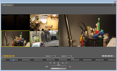

Multi-cam should work and I have confirmed it works here. The nested-sequence issue is easy to handle in all but 3D projects, it is a error in the interface between the Adobe API and CineForm plugins, Adobe provided the sample code that has the nesting bug, while support was technically correct, it is acknowledged that it is up to CineForm address (the new support person didn't know this subtly.) All is solved using a custom preset, we need to generate new presents so this is automatic. Something we are working on now.
If something support has suggested doesn't work for you, please follow up with support, as they can do a remote session to that step was missed (in their instructions most likely.)

Just got done with a remote session with Jake from Cineform.
It appears that there's an issue with the Mercury Playback Engine GPU Acceleration in Premier Pro CS 5.5. When it is changed to "Mercury Playback Engine Software Only", I'm able to do multi-camera edits normally (using "Custom" as the Editing Mode on the source and multi-camera sequences).
I wonder if this is only a problem with the nVidia GTX 570?
Anyway, thanks to Jake, it appears I have a workaround (switch the MPE to software while doing multi-camera edits).
Julian Frost is offline   Reply With Quote

...And got the "totally green screen" in the multi-camera window as soon as I opened it, just as before.
If I turned off the MPE Hardware Acceleration, everything works normally.
