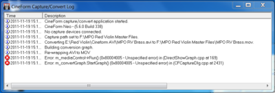

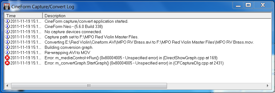

I'm trying to convert Cineform AVI files to MOV to edit on a Mac using HDLink.
The first time I tried it seemed to work, but with no audio after the first 15 minutes (approx 1 hour clips).
Now I just get an error (attached jpg) and nothing happens. I have to get these delivered this weekend and seem stuck.
Any suggestions?

Expand the log window so the times of the error can be seen, or is this not the 15min case? AVIs will edit on the Mac.

I'll have to retry it to see the time, it's not on the screen anymore, but this happens as soon as I start it converting, right at the beginning.
The very first time I tried it, it looked like it worked, I got a 64Gb output file, and the video played, but the audio is only there for the beginning of the video.
I cannot get it even start converting now, tried on two different computers with multiple original AVI's. This error comes up as soon as I hit "convert".

I got a response from Jake to my trouble ticket today, confirming it is a known problem that they are working on. His response was:
"This is a known issue with HDLink right now. Our engineers are working on it.
What you can do in the meantime is use the Mac version of Neo to rewrap the AVI files to MOV files."
