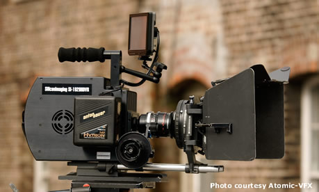

The SI site only talks about one unit, pictured here: http://www.siliconimaging.com/Digita...DVR_photo1.jpg. Numbers of $12.5k and $20k have been mentioned, but never described whats in the box. Company representatives don't show up on the SI forum here or their own community.
If a unit with an 'F' mount for Nikon SLR lenses, battery mount, hot swappable disk drive and live ethernet output was $12.5k, that would be attractive. Their FAQ says "The pricing for a camera head system, which includes the SI-1920HD-GE camera head, a copy of Prospect HD Edit, Premiere Pro 2.0, a Arri-base-plate adapter, and two Fujinon c-mount lenses will retail for $12,500." They are including 2 lenses for $12.5k but no battery interface or recording? If the buyer allready had Premiere Pro and Prospect HD, would it be less expensive?
It seems like a near ideal (it could be smaller...H1 or HD100 size) solution for no much more than an H1 or HD200/250. I just wish more information was available. Depending on specifics, it is either a great alternative or a little too expensive.
David Ziegelheim is offline   Reply With Quote

Pictured is the $20K solution. I also wish the SI guys would spend some time moderating the forum (I just direct everyone to DVInfo.net) but they have been very busy preparing their camaras for production. More information will come when the finally packaging is completed. As for pulling software features of a lower price, the answer is very unlikely (much of the pricing is for OEM bunded deals -- they get software much cheaper becuase it ships with every camera.) Although existing Prospect HD may get a break, but we all need to wait and see for the final package annoucements.
