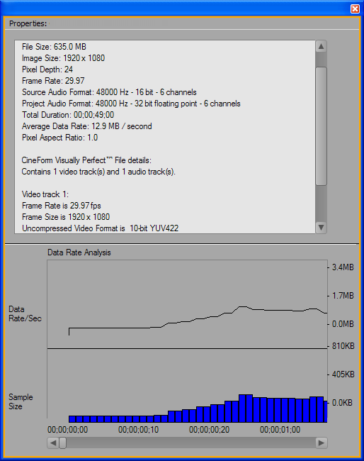

Where did you find V1.2 codec? For VFW we are up to V2.7. Either the file is corrupt or you have an old component installed. Your properties panel should look like this :

Also, see how in your screenshot it says Uncompressed - although it's AHD compressed? I get the same thing on the clips that DO play in real time.
The ones that do NOT play in RT in my 24p PPRo project show CFHD CineForm HD Codec V1.2 in properties.

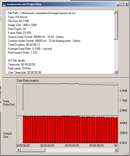

David, in your example data rate as a number is 12 vs only 9 in mine, yet mine does not play in RT.
What does the graphic representation mean, though? Mine looks intensely red - is that a bad thing? :)

My example was a 10-bit file, i.e. bigger. Can you email me a sample clip so I can see what is going on (use yousendit.com.)
