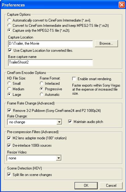

Old April 3rd, 2007, 02:31 PM   #8
Location: San Diego/ LA / Riverside, CA, USA
Posts: 28
These are the settings Ive been using:
Eric T. Edwards
Everchanging Productions
Eric Edwards is offline   Reply With Quote
Old April 3rd, 2007, 02:37 PM   #9
CTO, CineForm Inc.
Join Date: Jul 2003
Posts: 8,095
That is what you think you did but the first clip you posted is still interlaced (you forgot to deinterlace on that clip) that is why you are having problems. For more details please file a trouble ticket with support.
