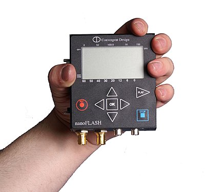

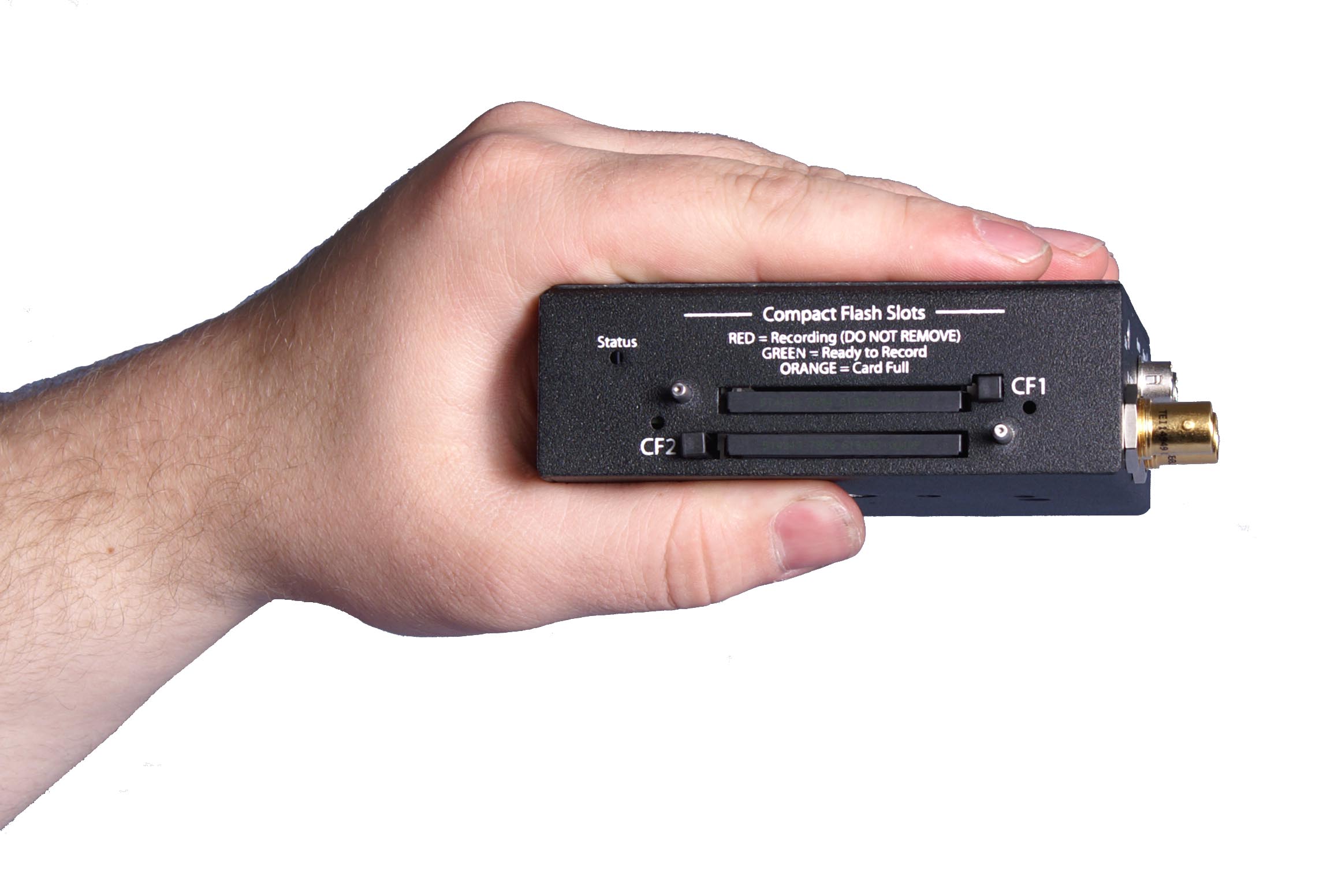

Snapshots of nanoFlash
Here are some quick photos of the nanoFlash.
(Note: We did not use a professional hand model for these photos, we just used a guy with the largest hands we could find! <grin>)
Our testing of the nanoFlash went very well today. We are bringing up and testing the circuits one by one. We are very pleased with our progress.
