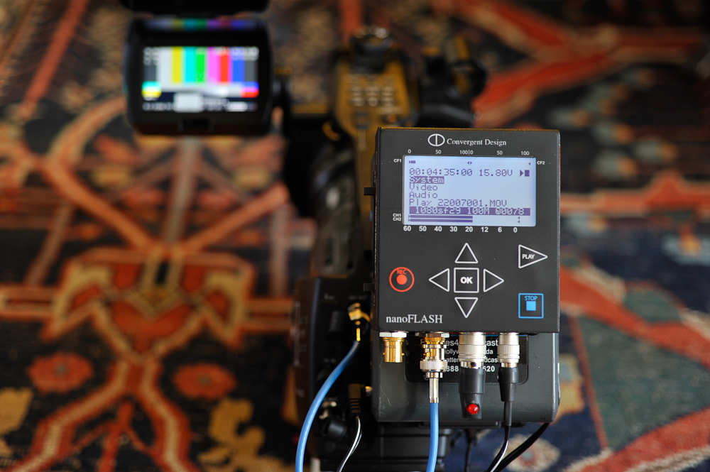

Hello Group-

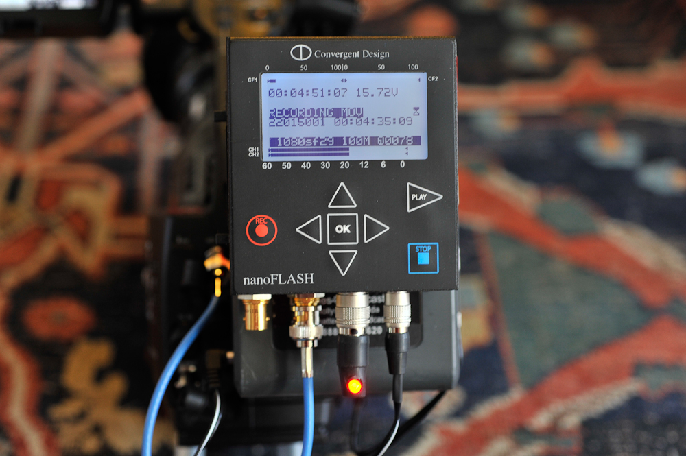

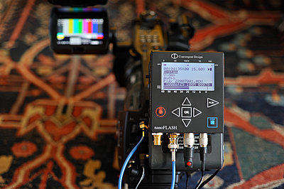

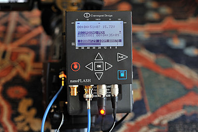

I cooked up a few gizmos for my new Nano yesterday. First is a simple LED tally that plugs into the 10 pin jack... no wires, but the LED is built into the rubber strain relief of the Hirose plug (at a 90 degree angle) and the end sealed with a clean dab of glue gun goodness. Small and Handy.

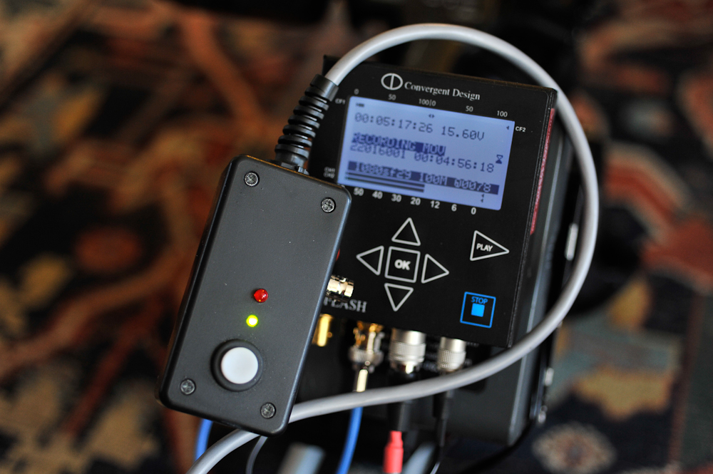

Second, a remote on 18" cord for a few different uses. Has green LED to show when the Nano is powered up. Large white push button is for start/stop and a red LED for tally. Also BNC spigot for external TC input on right side of box. If I need a longer run I will make an extension cable.

Tally light is a nice piece of work George. Really useful if you have your nanoFlash mounted with the display pointing away from the operator.

I agree that the blinking light can throw you off... it would be better as a solid on. Maybe an offering to the firmware Gods could resolve this?
Thank you for all the complimentary emails-- I like building things that are helpful and efficient. That is why I put the TC tap on the side of the box-- jam sync and then you don't have a pigtail floating around (scratching something). The push button is large enough to see and in the next model I will find a button with a LED built into it... help you find it in the dark and smaller box maybe.
