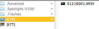

The shots below show the invisible files my macs put on the cards. They don't seem to cause any problems for me. I do reformat cards in the NF every time after transferring. Am I just lucky?

Mac writing to CF cards when inserted... Olof follow up
I looked up those files and found an article quoted here with link under that:
.Trashes, .fseventsd, and .Spotlight-V100
Merely plugging a removable drive into a mac (when it has write access) makes OS/X think it can take the liberty to write a lot of hidden garbage onto that disk. If you want to stop this from happening, you have to put some special files on that disk before you plug it in.
To stop OS/X from doing Spotlight indexing, you need a file called .metadata_never_index in the root directory of the removable drive.
To stop OS/X from making a .Trashes directory, you need to make your own file that *isn’t* a directory and call it .Trashes
To keep it from doing logging of filesystem events on the drive, you need to make a directory called .fseventsd and inside that folder put a single file named no_log
The contents of these files don’t matter, so you can make them empty files using touch. Even better, you could make it a text file with a link to this post, so that you (or someone else) wandering across the files will know what they’re for.
Apple’s choice to do this is incredibly self-serving and shameful. At bare minimum, hidden files and features like these should be off by default for any non-mac-only filesystem formats. They should only be enabled when the user has been made aware of them.
----------end quote----------------
from: .Trashes, .fseventsd, and .Spotlight-V100
So we are not alone here and this article if correct suggests some ways to prevent some card add-ons. I hate to be the first one that suggests adding these blocking files to the format routine in a future firmware release. I will look into this more, maybe there is a way to prevent these unwanted card writes.

Dear George,
Thank you for providing this very valuable information.
At first glance, it certainly seems reasonable for us to add these files when we format the CompactFlash card.
In the meantime, we recommend:
Before using a CompactFlash card for the first time, format it in the nanoFlashs or Flash XDR. We made the format process very fast so this is really painless. It just takes us about 2.5 seconds per card to perform the format.
Record your files.
Upload your files to one, preferably more than one, other storage system, such as a Nexto or laptop or other computer system.
Reformat the card, in the nanoFlash or Flash XDR, prior to using the card again. (I prefer doing this at the start of the shooting day.)
These days, with 64 GB cards being relatively economical, it certainly is feasible to have a full days worth of cards available on hand.
We are having great results with the Delkin 64 GB card. While this card is currently limited to 220 Mbps speed at this time, we hope to increase this card's performance to 280 Mbps in the future. (This is not a guarranty, just one of our goals and this is in our plan.)
