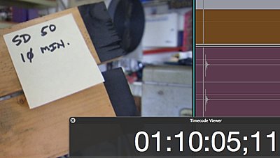

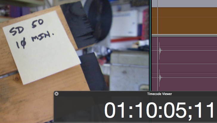

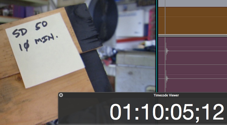

I did a sync test this AM with my SDX-900 using the SD 50 setting on the nano and I can't tell if it is OK. I have brought a 10 minute test into FCP and did a few screen grabs with the canvas showing a slate (homebrew), time line with audio waveform, and frame counter.
When I play the clip it is in sync after I play it once*, but the audio waveform on the time line shows the audio 1-2 frames late in reference to the video. I will do more testing, but was wondering if anyone has time over the weekend if they could try it out and see what they come up with. My hunch is that the FCP time line is drawing wrong and the clip is in sync. I will be rolling tape Tuesday regardless.

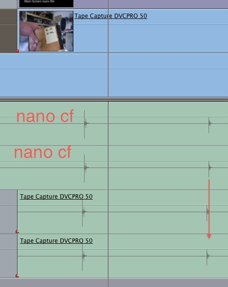

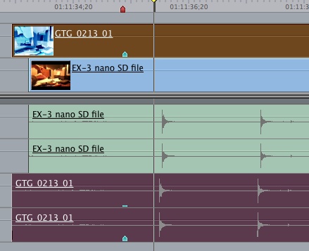

Test Conducted... audio late
This issue is still under review with Dan, but so far looks like we are not out of the woods with SD audio delay. Did an SD test using Panasonic SDX-900 in MOV and MXF and audio is late by two frames maybe one. See frame grab from FCP that shows two time times with two tracks of video synced (one nano and one tape capture) and see the waveform of the audio with audio peak offset by the amount of delay. Test with EX-3 set to SDI down convert to SD and produced same result.

EX-3 MOV of sync delay <<goes with previous post>>
Goes with previous post. EX-3 with SD SDI output has same delay in audio as SDX-900.
