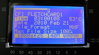

Temp
Hi Dan,
Just to check on the Temp, it's now at 53degrees celcius, and it's only been running for about half an hour. I've attached a pic below.
Fletch.

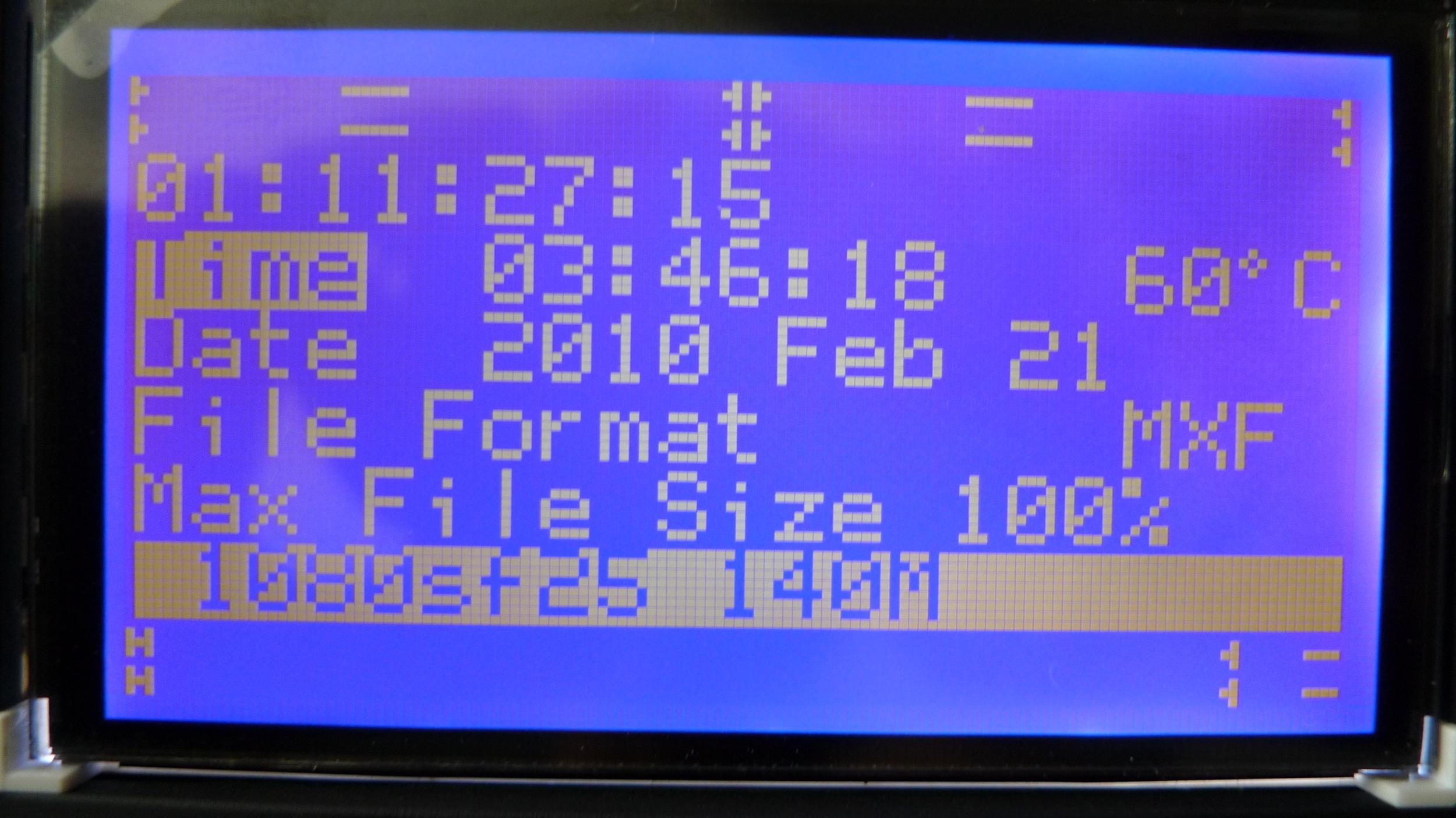

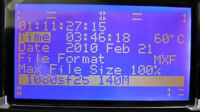

Old February 20th, 2010, 11:06 PM   #5
Join Date: Jul 2005
Posts: 20
Temp
After an hour and ten mins of continious recording, the temp hit 60C. I didn't want it to get any hotter so I stopped recording, ejected the cards, and took a pic. This test was done in my office recording just the room (it's a/c controlled at 25C).
