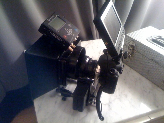

Thru Bruce's link, found this intriguing photo on the Syndicate's website.
It shows a 7D rig using a nanoFlash to apparently record the output. Not a lot of details about the nano to fully understand what is going on there.
Syndicate - Canon 7D BNC-R Cine HD.
Photo of nano on the 7D attached.

Of course it's nice to see that no cables are physically attached to the Nano. That way they aren't misrepresenting what's happening here.
On the other hand the cable-free profile looks very clean.
Dave Sperling is offline   Reply With Quote

Yep - it's a mystery alright. Was hoping someone at CD was working with these folks and could shed some light on this.
