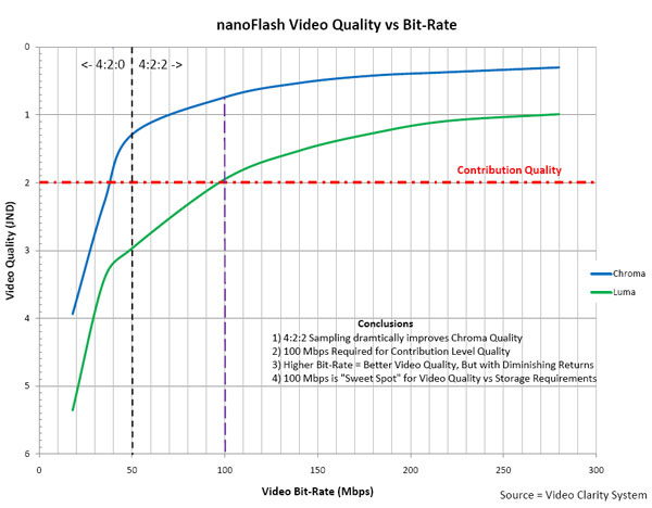

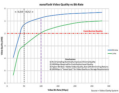

Dear Lance,
Here is a chart that we created from our tests of the nanoFlash using the Video Clarity system.
Note: A lower number equals a better image based on Video Clarity's modeling of human perception of image quality.
Lower numbers plot higher on the chart, thus as the line gets closer to the top of the chart, the footage is higher in quality according to Video Clarity.
Our tests were performed using a high quality test file of a football game and this is not representative of all types of footage.
Just click on the chart to enlarge it, otherwise it i not large enough to actually read.
Red/Pink line ?-vidqualvsbitrate.jpg

Dear Lance,
Hey Dan: I was checking out the chart you posted, and I couldn't help but notice a significant gain in quality between 100 Mbps and 280 Mbps in both the Chrominance and Luminance signals.
