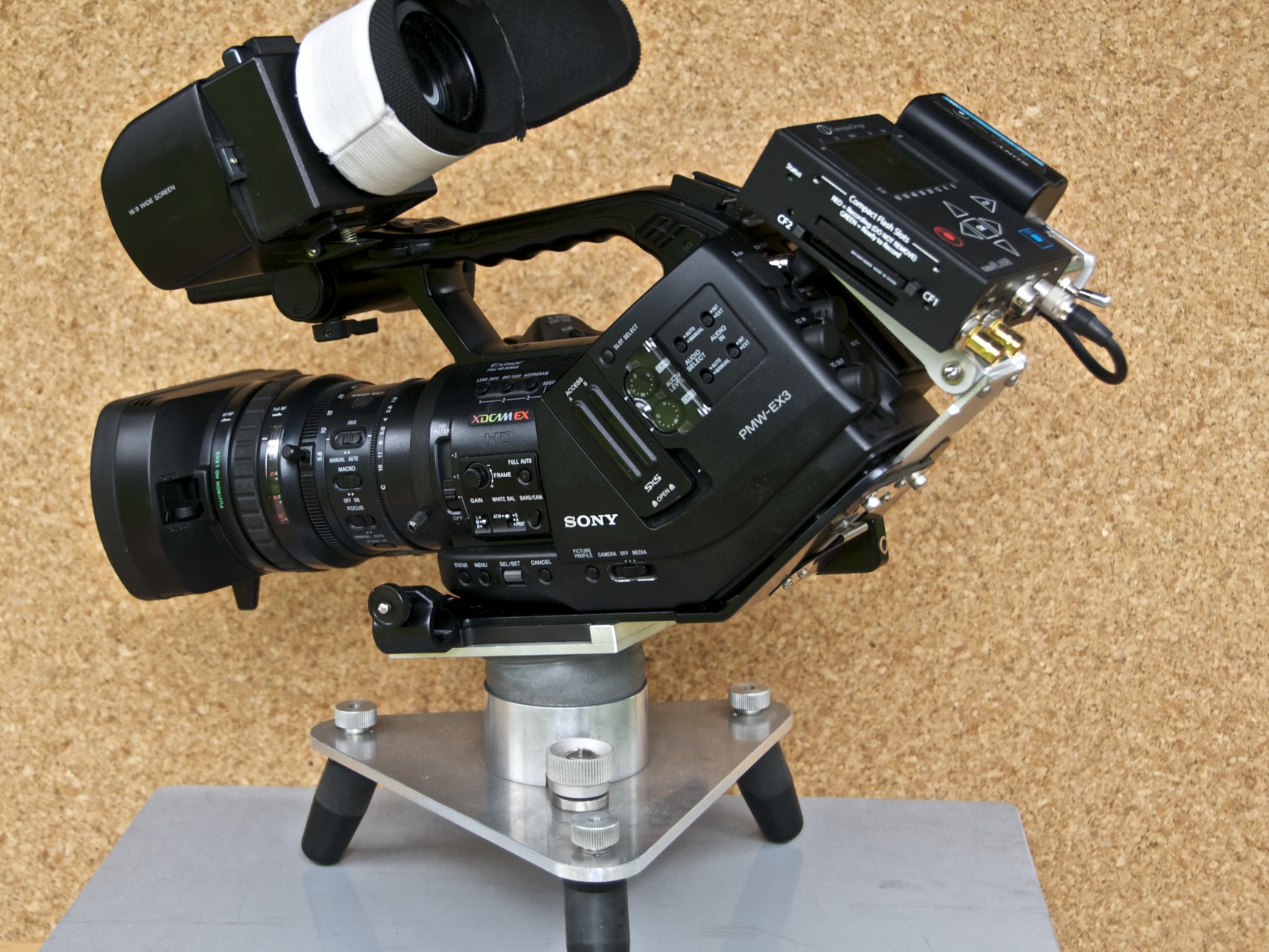

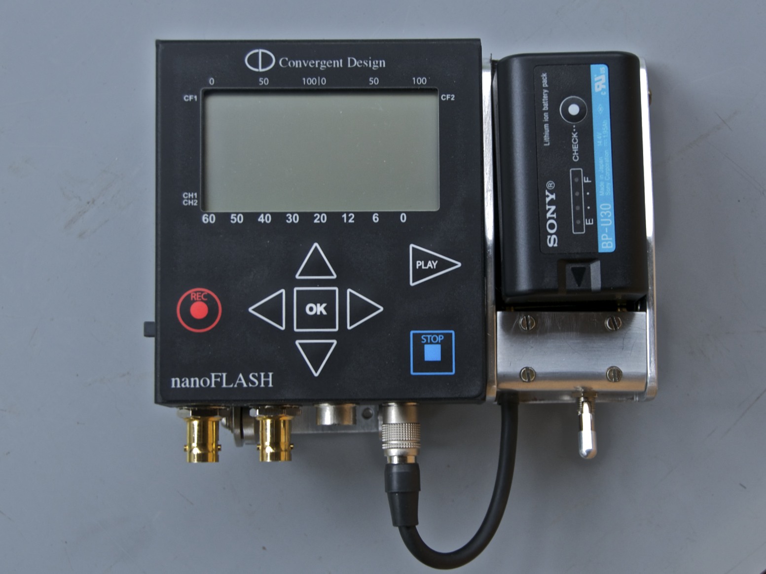

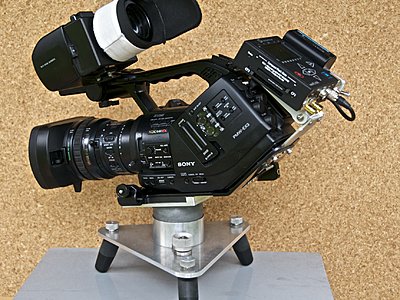

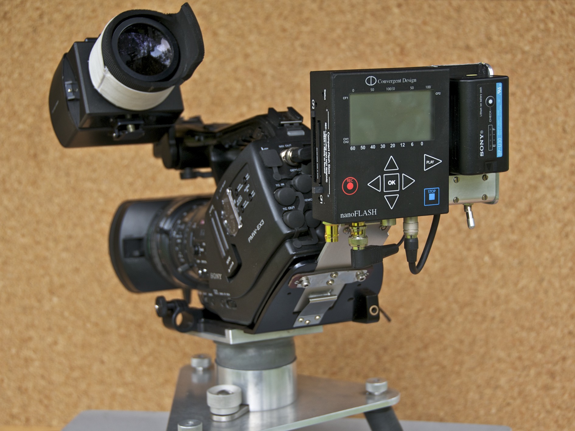

I have now added a switch to my nanoFlash. While I was at it I added a battery holder as well. To turn the switch on or off the toggle has to be raised first which is something that is very difficult to do accidently.

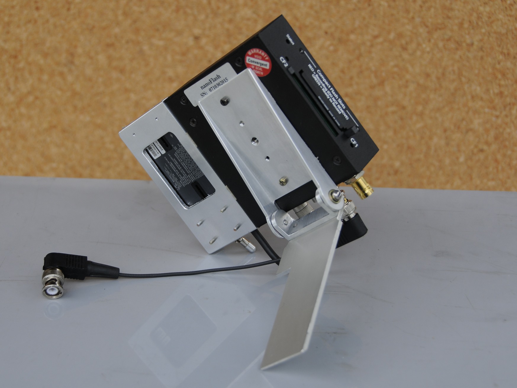

To attach the combination to my EX3 I fitted a hingeing “tongue” to the back of the nanoflash that snaps into the back of my EX3 base plate. It uses the same mechanismas I use for a lightweight shoulder support.. When the nanoFlash is removed the tongue can be folded down for storage.
An advantage of the hingeing tongue is that the nanoFlash can be tilted forward for low level use or tilted back for more conventional use. Should everything work as Ihope the pieces will be cleaned up, anodized and dyed black.

Hi Alastair:
Very nice quality workmanship indeed. I can tell you've put a lot of thought into the design to make it have the smallest foot print as possible. I like the fact that you can modify the position of your Nano Flash while it is attached to the back of your camera. I have a mounting setup for my XDR on the back of my XL H1 and it is a very solid mount, but I cannot tilt it back forward toward the front of the camera to change the weight balance and cable positioning, which I would like to be able to do on occasion. Can you post some more close up images of your "hinging tongue" assembly so I could have a closer look at what you did ? I would like to make a modification bracket for my existing XDR mount.

Mark, the photo of the back of my nanoFlash probably shows it all.
As you have probably guessed I made the base plate for my EX3 myself and included

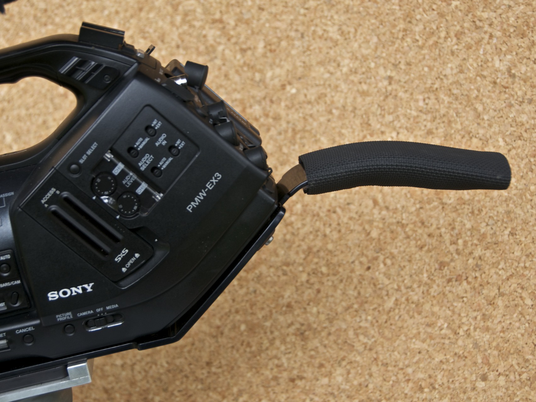

a couple of features I have not seen in other models. As I intended to use Nikon lenses I built in a simple lens support that also acts as a way of supporting the left side of the camera. In an attempt to reduce weight I cut away some of the metal from the rear of the base plate. I realized that if I kept the sides of the cutout parallel I could slide things into this space. The shoulder mount slips into this space, the sides of the cut out prevent sideways movement and I added a pad to prevent vertical movement. A sprung clip catches the tongue when it is fully inserted. To remove I raise the clip and pull the tongue out.
The hinge unit as I made it has three components plus fasteners. Firstly a piece of channel that attaches to the nanoFlash using the holes provided. The tongue was made out of a flat strip and machined to match my base plate. To hinge the tongue to the nanoFlash I used a short piece of channel attached to the tongue. This channel was narrow enough to fit between the legs of the first and with enough space to fit fibre friction washers between the mating surfaces. I used screws and spring washers for hinge pins. When I was happy that there was enough friction I used a “Wick-in Loctite ” on the screw threads to maintain the adjustment.
