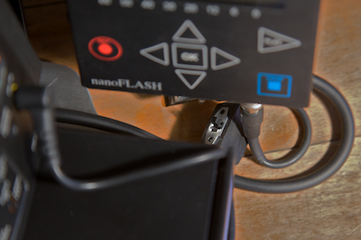

I recently purchased a nanoFlash and I am a little puzzled by the lack of an on/off switch. My current project entails numerous short takes with anything from one to ten minutes between shots. To conserve battery power I turn off the camera and unplug the nanoFlash between shots. This is a little tedious and I have already snagged a dangling lead as I ventured through vegetation. For such a sophisticated and versatile device this means of powering seems a little crude. It is even more puzzling when I read that the first nanoFlashes had switches, later units had non-functional switches and current units have no switch at all.
I have not finalized my setup re brackets and cables etc as I wanted some field experience first. Is there any reason why I should not install a switch somewhere?

I make a small inline switch for the NF.
It is a pretty expensive to make. The Hirose plug is very pricy and hard to solder (very small pins) the switch I use is a slide switch similar to the on/off on a EX camera.
I mill a small plastic box from it out of solid plastic. I can not find a good quality small switch pre made.
I use these myself and have made a few as part of custom cables for shooters. Usually the other end is a D-tap.
I have not found a great demand for these, but if you are interested contact me, or post here.
If a lot of people would like these it would be less expensive to make them in batches.

I bought the nanoFlash bundle that is considered to be a starter kit. It is very useful for that but I soon found that I miss an on/off switch. I would prefer a toggle switch because you can see at a glance whether it is on or off. Slide switches such as used on the EX3 although hard to knock can be very vague.
I once purchased a small well-made toggle switch at a flea market. To actuate this switch you first had to raise the toggle against spring pressure then move the toggle to the alternative position. Releasing the toggle locked it in place. It was impossible to knock on or off, however I have never seen another one like it. Does anyone know if they are still made and if so where to get them?
Alco has a complete line of locking toggle switches, including the kind where you have to raise the bat before you can switch states. DigiKey, AlliedElec, and Newark all carry pretty much the whole alco line.
Search for "alcoswitch" in Google.
