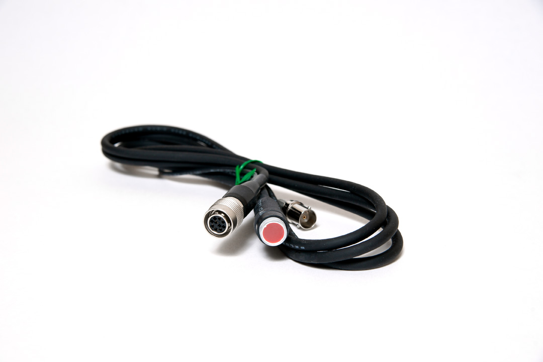

Dear Anthony,
Here is a picture of the Remote Control Cable, with Tally Light, and Timecode input.
Remote Trigger for nanoFlash-convergent-design-25-nano3d-nanoflash-remote-control-timecode-cable.jpg
Dan Keaton
Augusta Georgia

Then the one Mike suggested is like that, minus the BNC end.
So is the record button is also the tally light
Did a bit of searching, Is it,
10-Pin Female Hirose to Remote Control with Tally, 1.8m
Thank you.

Dear Anthony,
You contacted Mike Wattley of Symbiosis. You mentioned nanoRMT-LTC.
The picture in the last post is the one typeically sold by Symbiosis, and should be available from our dealers in the UK / Europe / Middle East and Africa. Or they may have a custom one.
Thus the one in the picture is nanoRMT-LTC. This one has a Female BNC connector for timecode input to the nanoFlash.
We can build these with a wide variety of options. and lengths.
Do you want to have the ability to input external LTC timecode into the nanoFlash, now or in the future?
