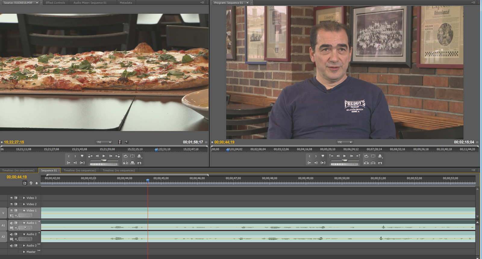

I shot a 20min video today using 220Mb I-frame with 32GB SanDisk Extreme cards and an EX3. I just began editing it and the 2 tracks of audio go out of sync periodically. (I use Premiere Pro CS5 5.0.3)
Here is the first clip recorded and half way through, you hear the echo. Just checked all the footage and only this first clip has a problem. The original SxS recording is fine. Why is this happening?
The image is a view of the waveform right where it begins to go out of sync.

Hey Steve try playing the clip back out of the Nanoflash direct to a monitor to see if the audio issue is still there.
This way you will know if it's a Nanoflash issue or a Premiere Pro CS5.

Just played from the nanoFlash and did not hear any echo so it must be an Adobe issue. The audio is embedded from an EX3.

Hey Steve it may not be a problem with Adobe. I have seen the same thing on other NLE's and it turned out to be an audio mixer issue between input and output.

Well, I found the audio out of sync yet again on a shoot from 2 weeks ago. This time, I used 50Mb L-GOP. Everything else was the same. This is very frustrating and makes me not want to use my nanoFlash.

So far, it plays fine through my Panasonic BT-LH1710W HD-SDI monitor but I don't know if this monitor plays both audio channels. I can test playback using my Sony HDTV via HDMI but I have to copy the file back to the CF card. So, is there any special process for copying - do I just copy the file into the main folder?
PS I did a quick shoot today at 50Mb L-GOP and it works fine in Premiere Pro.
I just went back to the clip from earlier today and now it is in sync. Only thing I can think of is Premiere had to re-conform these files, and maybe this is where the Adobe software is going awry.
