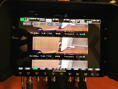

I am trying to monitor an FS700 and a Canon 5DII and I am getting no love. In fact the Odyssey does not seem to like this combo at all. I've got the FS700 coming in SDI-a and the 5D coming in the HDMI. The HDMI feed seems to take over the device and I cannot see the SDI feed. Also, the HDMI feed is horrible looking and has big refresh lines crawling up it. I have it in Multi-Stream mode. I've tried SDI-b to no result. Is this not a feasible monitoring combination?? Both feeds look fine by themselves without the other connected.
Also, when I have Multi-Stream enabled it says "Demo." I thought this was a feature that came with the device??
This photo shows how the Odyssey displays the 5D when in Multi-Stream mode. SDI does not even show up.
www.elkinseye.com
Last edited by David Elkins; February 26th, 2014 at 11:48 PM. Reason: added photo.

i don't think you can mix HDMI and SDI into quads at this point. somewhere in my head, i believe it's slated for a future addition, but i could be wrong. i generally don't use HDMI, so I'll admit to not paying much attention to this input.
DEMO shows as the recording capability is a DEMO function only - but the viewing is, indeed a built-in/no cost function. I, too have requested that the DEMO marking be removed and I've been assured that's on the list.

In our initial firmware release, the HDMI input was not supported in Multi-Stream Mode.
In our initial firmware release, in DPX mode, as I currently understand it, the HDMI input has priority, thus if there is a signal on HDMI, then that is what is used.
I do not know if just having a HDMI cable connected is enough to cause it to use the HDMI port.
David - the 5dmk2 does not output a full res or clean HDMI signal - could this be the cause of the bad image?
The 5D image looks fine when it is the only input. It only goes wonky when I also have SDI inputting as well.
Funny how CD did not enable simultaneous HDMI and SDI viewing. This is a standard feature on other monitors with both inputs. Yet another reason to be leaving my Odyssey behind AGAIN and going back to my old tools. That waveform sure would have been handy tomorrow. Ugh.

Figured out a kludgy workaround. You can leave the SDI plugged in at all times. When you plug in the HDMI the Odyssey defaults to that stream. To switch between the two you just remove and plug-in the HDMI as needed. Looks like the Odyssey will be making the trip with me after all. :)
