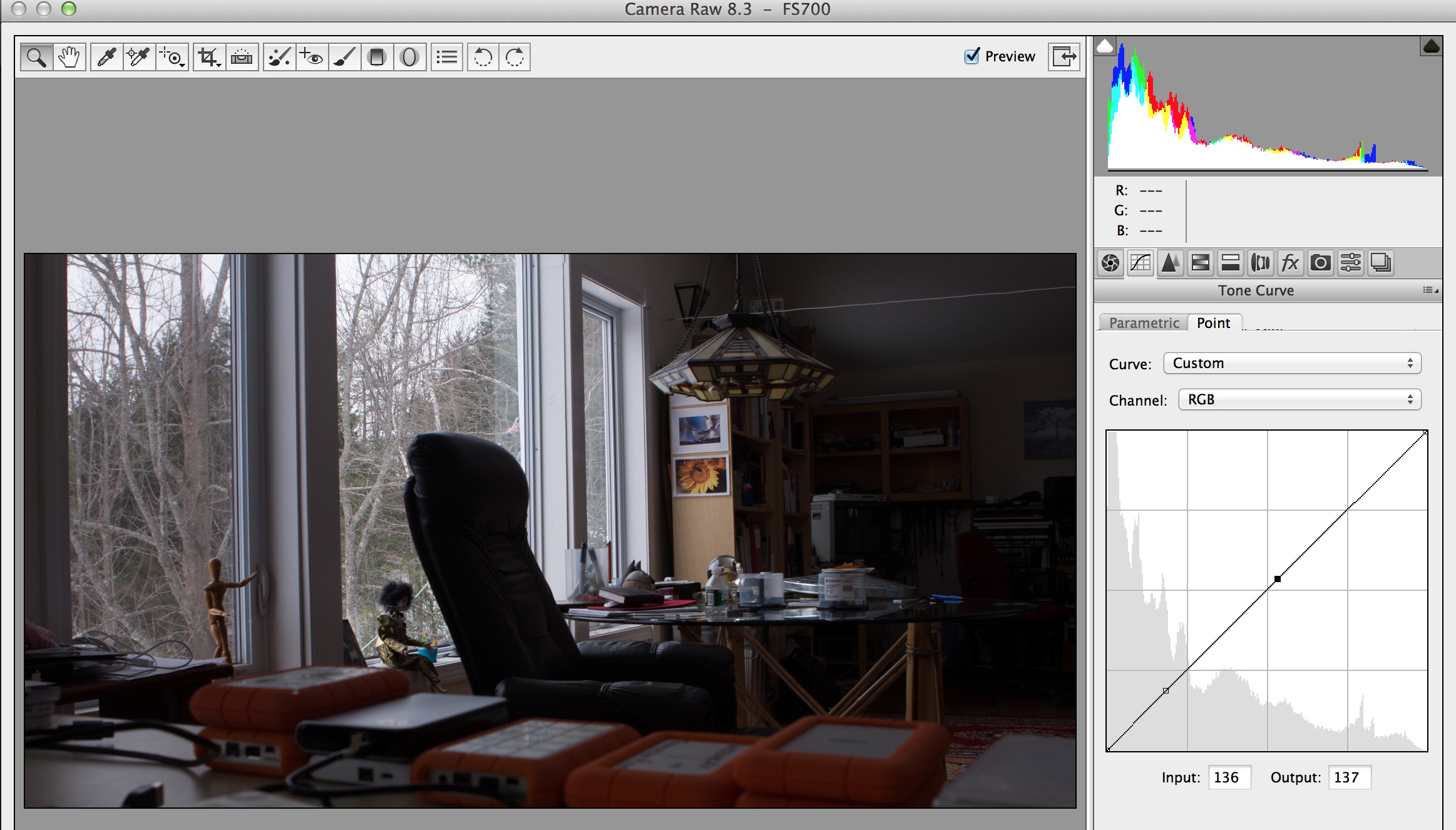

Here is a sample, this is a very tough scene in my studio, bright outside and totally unlit interior. I would say at least 12 stops needed to make this look good. So a kind of camera torture, normally you would light a scene like this.
I am very happy with the quality I am getting from the FS700, this is iso 2000 29.97P set using the WF and zebra in the O7Q. Very easy to see what you are recording.
The lens is a Canon 24-70 f2.8L at 24mm f13 v1 180 degree shutter (1/60).
The detail and lack of noise is very impressive. There is no color grading at all just set to 5400K in Camera.

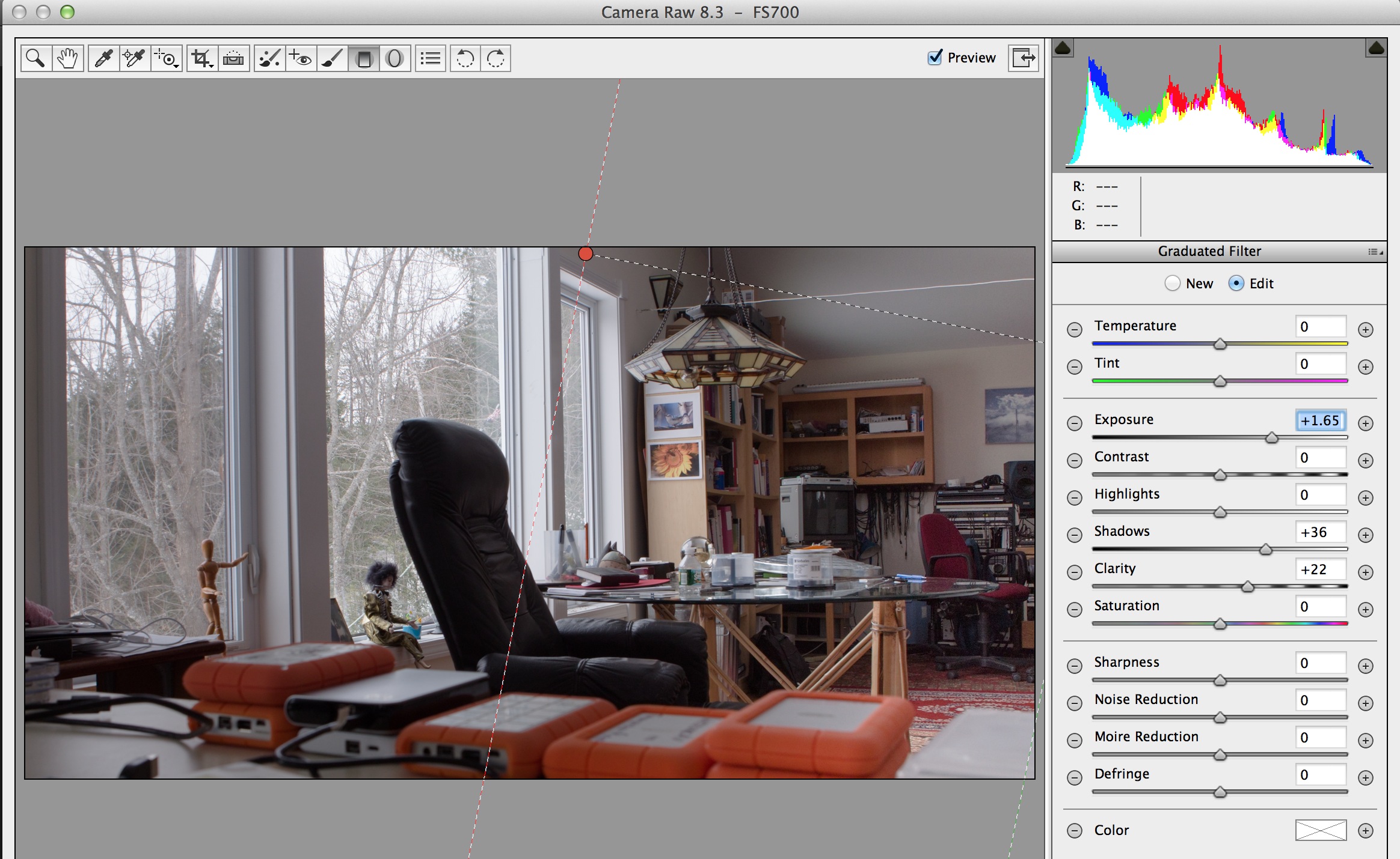

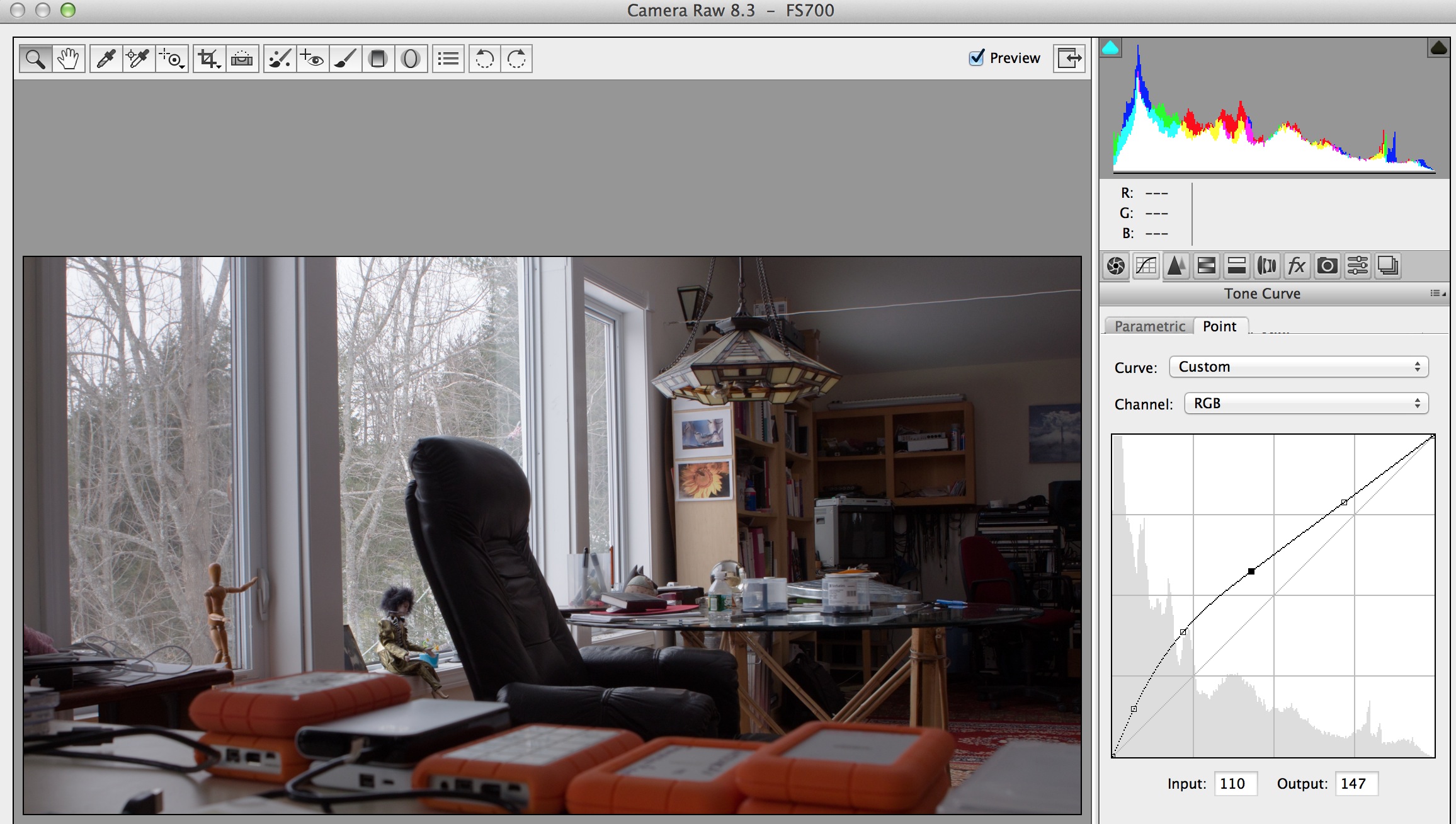

Below are some images showing the workflow and a JPG of the finished grade. I just put in a curve to raise the blacks and mids, then added a secondary to the right side increasing the exposure 1.65 stops and upping the mid contrast (clarity).
