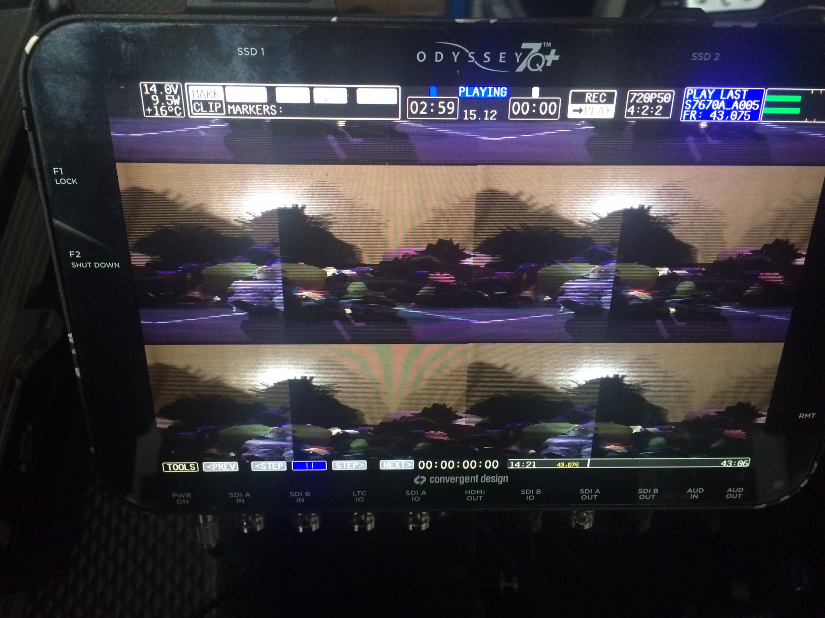

I had an used SSD (original CD) with 1080p files with 400Gb of space left and used it to additionally record a 1-hour 1280/720p50 file. I did a quick test before the actual recording and it seemed ok. after the show I recorded, I replayed parts of the master file and so far everything was in order.
I soft (and then hard-)ejected the SSD on the 7Q+ and connected it by the on-board sata-cradle on my computer and it says there are no files... I restarted the PC and used a Inatek USB3 reader and it still shows no files. I checked it on a separate MACbook with the USB3 adapter, still no files
As soon as I stick the SSD in a 7Q+ it shows all files in play mode, but it looks odd while playing a shifted quad-ish look with interlace-like lines (see attachment)
The original source was a professional switcher with native, stable 720p50 output, as all the other connected devices confirmed, so nothing to look for there.
How do I get my files?

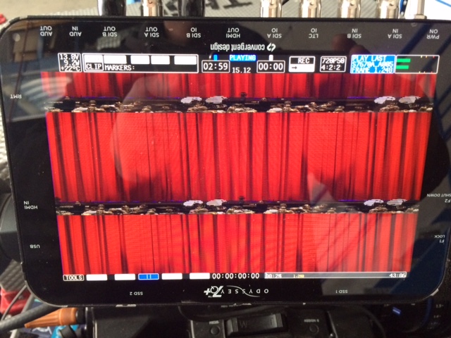

I still have issues with replaying files on the 7Q+! I see Unsync in horizontal and/or vertical framelines. (attached) Doesn't look very professional to the rest of the crew and director... Actually a bit embarassing Is this cured in 2016FW?

In general, we do not recommend updating firmware in the middle of a production.
We have been making improvements in many areas, including playback.
If you have a day off, you could load the latest firmware, then test. You could always go back to the December firmware release.
