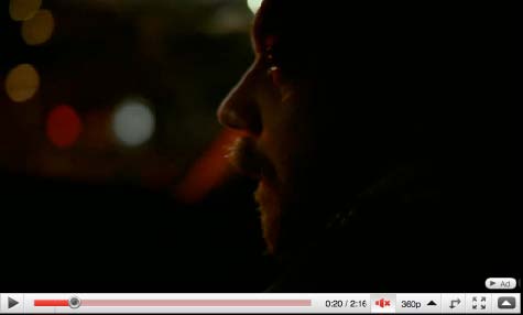

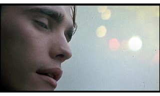

I'm shooting a short where I would like some bokeh circles (out of focus highlights) to appear for a few seconds, behind a character. Like jpeg 3.

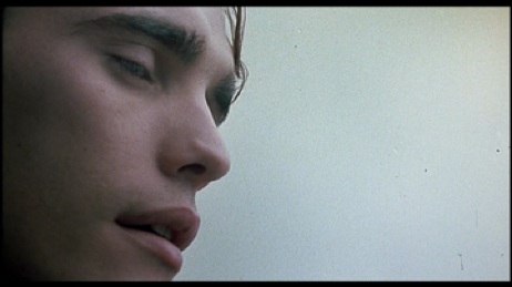

I was planning to achieve this with my 35mm adapter and some clever staging. But unfortunately my adapter is being serviced so I only have use of my HD camera. What would be the easiest way to accomplish this in post? The effect would occur when the character is in a moving car, during the day. I figured I should frame the shot tight like jpeg 5, with the lead space containing only blue sky. I would like the bokeh to appear in front of him, if possible. Is there a plugin I could get or could some animated bokeh be overlayed on the footage? I don't know AE, so some advice would be appreciated.
Here is a bokeh effect I found on youtube.
YouTube - Blackberry U2 HD

It's easier to achieve this with night time/darker shots like that jpeg you've attached. You could do it with your HD camera as is, if you could get far enough away and zoom in. Which doesn't sound like an option.
But there aren't any effects that I know of that do this. The only way I know to get anything close to this effect in AE is by using blur filter in 32bpc (click the bottom right of the project window, usually set to 8) -I hear it also needs to be in a linear color space whatever that means. That supposedly makes the image effect more like a camera's lens. If you can shoot it a bit shallow to begin with you may be able to mask out the soft area and enhance it a bit more. I would guess that the mask could be a bit rough and feathered like a vignette if there's not too much movement of the camera and subject (so you wouldn't need to mask frame by frame or anything.) Try a test with a random still maybe.

Hi Ruben. As Shawn says you could achieve this with particles or several other ways but if you are not an experienced AE user it will take a long while to get what you want. I would suggest that you use footage of real Bokeh (shot at night with a black background - defocused Christmas tree lights of the colour(s) you want spring to mind)) lay this over your footage and use a blending mode like Linear to mix the two images together. If the bokeh is moving and goes behind your actor you will need to rotoscope (mask) his head out and place that above the other two layers. I've done a rough version using your two images to give you an idea of the effect. Hope that helps.
Edit: After numerous attempts I still can't upload the image??????? But have a try with your two images yourself and you'll get the idea.
