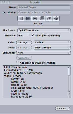

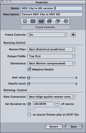

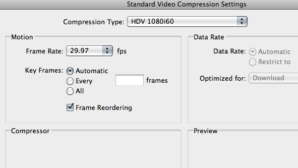

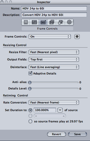

There are two options when converting from 24p to 60i with Compressor.
(1) Do you prefer smooth motion and the temporal interpolation to be spread across all frames? Then you'd choose "Best" settings for the conversion in compressor.
(2) If you prefer frames 1,2,3 to be "clean" and only frames 4,5 of each 5 frame set to be "interpolated" then you would choose the fast settings.
I've attached images of the Compressor settings and three HDV movies:
HDV-24p-Original.mov (the original 24p movie)
HDV-60i-Output-Fast.mov (conversion output using the "fast settings' with crisper image and faster conversion)
HDV-60i-Output-HQ.mov (conversion output using the "best settings' for smoother temporal conversion)
It's instructive to loop these and look at them on both a progressive and interlaced display at full screen. It's also interesting to note that the conversion of the "fast" version took about 15 second on my laptop, but the "best" took like 90 seconds, so a long piece of footage is probably better converted on faster hardware :-)
David.
