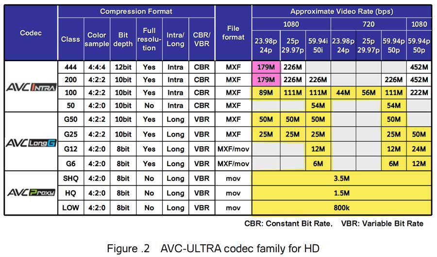

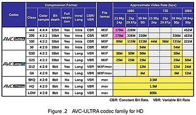

I've done some research and discovered that these formats don't relate to the bit-rates in the way I expected. I expected Intra100 to always be approximately 100Mb/s, no matter what frame size or rate. This is not the case. AVC-Intra100 at 50p runs at a whopping 222Mb/s.
However, there are still some 1080p50/60 formats that come within Micro-P2's maximum write speed of 200Mb/s
In theory, the PX270 using Micro-P2 would be capable of supporting all the formats I've highlighted in yellow and pink. From the wording of the PX270 preliminary sales brochure, it sounds like the pink formats will be optional.
But also notice that the PX270 has a single full-sized P2 card slot. So it's anyone's guess what it might be able to handle.
I'd take that 222Mb/s figure to be a nominal 200Mbs, but it's correct that the whole AVC-Intra/AVC-Ultra nomenclature system is a confusing mess. Hence it would be possible to record 1080p/50 to microP2 in Class 100.
As evidence, look at the original press release for microP2. Panasonic Announces April Delivery of MicroP2 Cards at DV Info Net
That says: " The microP2 cards will guarantee data writing up to the class200 mode of AVC-ULTRA, the company’s newest compression system***. Then the note adds "***With the exception of 1080/60p/ 50p within class 200."
I take that to mean they WILL record the 222Mbs modes - 1080p/50 at Class 100, and 1080p/25, 720p/50 etc at Class 200, but WILL NOT record the 452Mbs modes such as 1080p/50 at Class 200.
