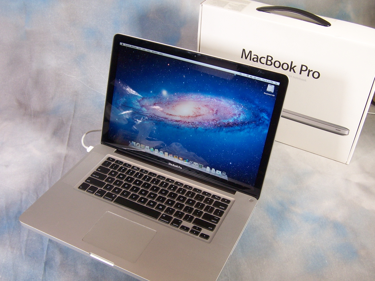

There is some more stuff I've read about my MBP group:
This came from a Craig's List ad I read a few months ago:
"Now before you consider any other Mac Book Pro read this. Fact is a lot of them failed due to overheating and solder issues.
I paid a company in Renton to actually "re-flow" the whole motherboard with thicker better solder. Hence.... no breakdown from overheating issues. "
And this was from another ad:
"Early 2008 (aluminum) MacBook Pro with the following specs that I’d like to trade/trade plus cash for a…. It has the following repairs/upgrades:
New, Upgraded Logic Board - $500 (Apparently an issue with all of the non-unibody models, beware of using one that has not had a new one installed as it can completely mess up your graphics capabilities)
New screen and Top Clamshell assembly - $500
New Keyboard/Trackpad/Top Surface - $120
New Audio Interface Module - $85
New Magsafe Battery Charger - $65
New Battery - $100
All of the repairs, with the exception of the logic board (10+ months) were done by Apple in the past 4 months."
This is kinda scary. I don't look at a laptop like this as a "consumable" and for this kind of money I expect it to last a while. But, it looks like one might have to manage the heat, at least that's my guess. That's why I got the old Mac Pro so I'm doing all the heavy heat generating stuff on it and saving the light-weight work items for the MBP.
Mine is a "Late 2008" but I'm not taking any chances.
