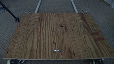

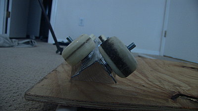

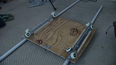

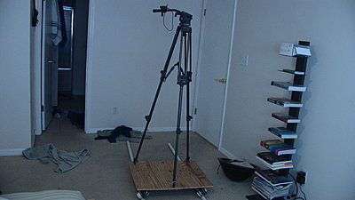

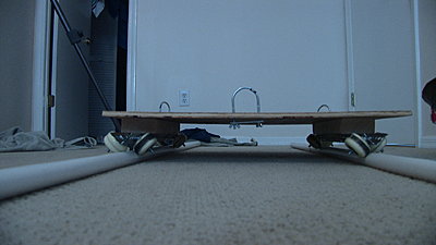

Here are some pictures and a price breakdown:
(8) Skateboard wheels - $19 (2 decks from walmart)
(1) 5ft pre-drilled V-Shaped Metal Rail
(8) 1.5inch bolts
(1) 5ft 2x4
(16) 1inch Washers
(16) 1/2inch Washers
(1) 4 x 4 plywood square
(3) U-Bolts with wingnuts
Home made dolly and footage...-img_0102.jpg   Home made dolly and footage...-img_0103.jpg
Home made dolly and footage...-img_0104.jpg   Home made dolly and footage...-img_0105.jpg
