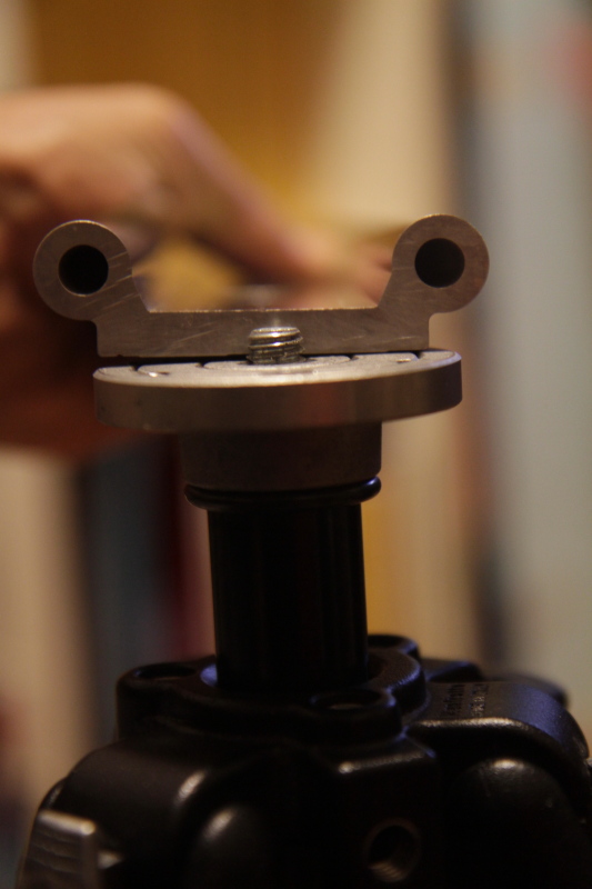

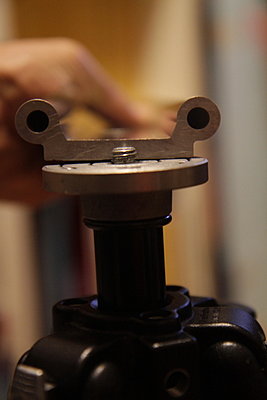

Hi,
I just bought a 75cm rail from Igus and I have this problem: the Manfrotto screw is shorter than the rail thickness (you can check the pic.) Therefore I need a longer screw if I want to put it straight in the rail. I have to drill the rail because there's no holes right in the middle of it (it's 75cm long).
Do you know if I can change the screw? Another option (that I'm trying to avoid) is to screw it to the tripod head but that would mean using 2 tripod heads.
Any help or idea would be really appreciated.
Thank you,
Javier

Hi Javier,
I think my Manfrotto tripod (don't know the exact model #), has the same height bolt as in your photo.
Take a look at this photo of my DIY slider:
DIYDolly_05 on Flickr - Photo Sharing!
(Sorry it's not the best photo to illustrate an answer.)
If your only choice is to mount the rail on a tripod head, maybe you can buy a Manfrotto quick release plate and just keep that mounted on the rail?
Best,
--JA
