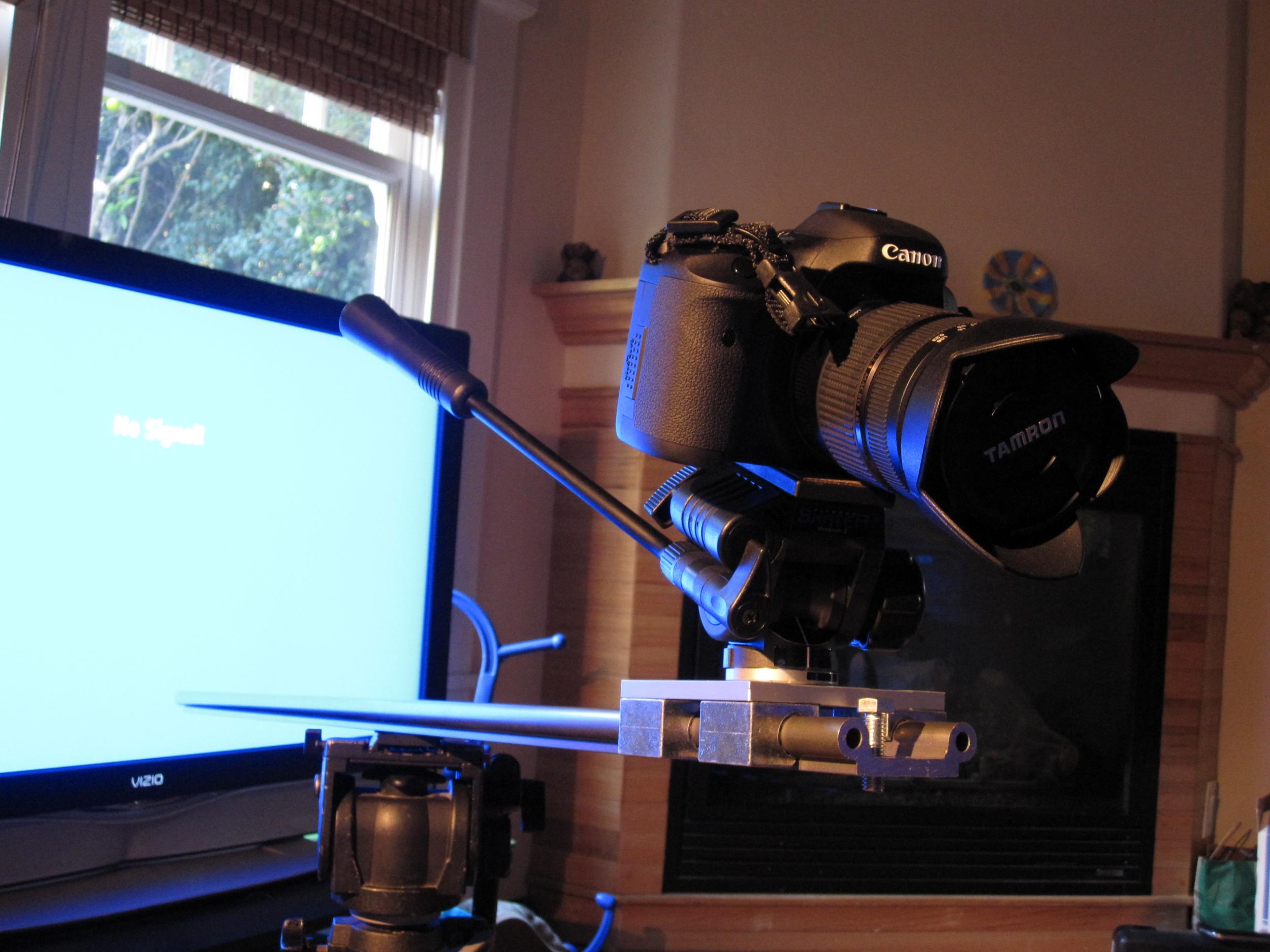

I was going to shorten my 39" Igus slider to make it more portable. However now that I know you can easily use the Igus + DSLR as a mini jib, I think I'll keep it at 39". This jib set up is brilliant. Dunno why I never thought of it.
Canon 7D is so light you don't need counter weights.
Photo attached.

Nice! (More photos if possible) What head is that?

Posts: 2,290
the big head is a Bogen 501, the head on the slider is a Slik -- a light inexpensive one, doesn't even have a model number on it.

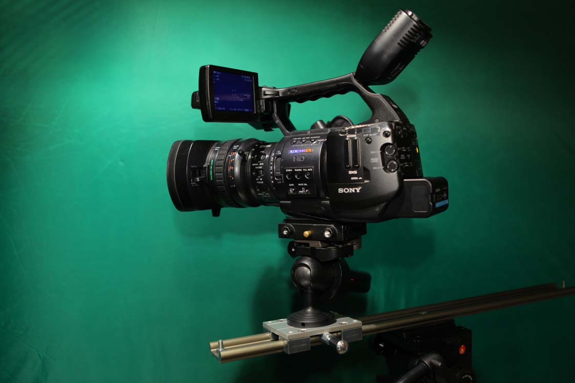

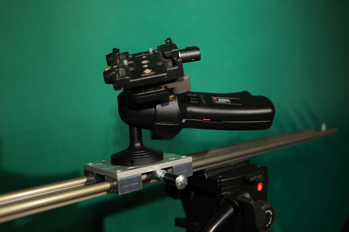

this is what I use for both EX1 and 5D
with ingus rails being so inexpensive, I have three of them, 20" 40" and 60", but I rarely use 40" and 60" cuz for those I need 2 tripods;
20" is great on a single tripod, it's long enough for 3-4 sec. shot, and Manfrotto 322RC2 is strong ehough even for EX1 abd BP U60,
It is not as smooth as Cinevate's pegasus, and takes a bit more practice (like 5 minutes :) but it's lighter, smaller and much less expensive :)

Looks great! Do have some sort of brake on your carriage? Looks different from mine.
