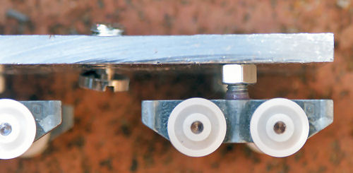

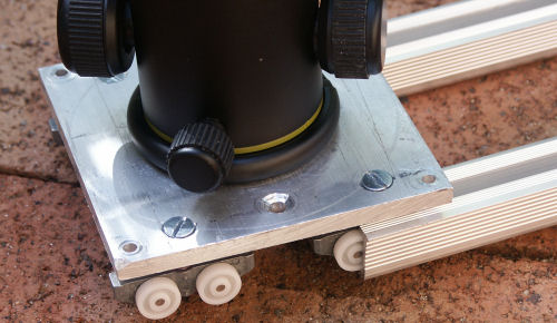

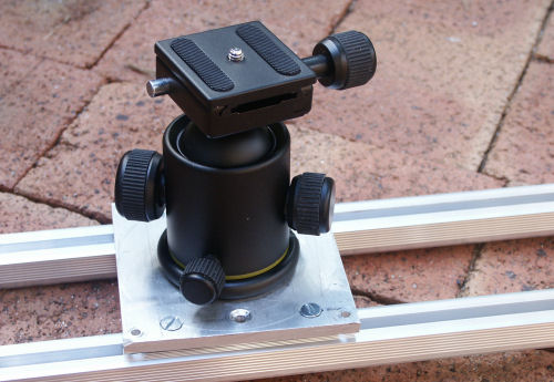

Interesting developments ... using 6 wheel units I found the the carriage struggles a little and more than often some wheels are not even in use. As the track is equally smooth on both sides I have found it works way better if you discard the top 4 sets completely!! I am just running 4 units inside the track bolted to the plate and they run smooth as silk. My upper wheels also skewed quite badly and despite making all sorts of guides the wheels still mis-behaved!!! By running just 4 of the little 4 wheeled units (all inside the track) it runs way better!!
Cheaper too as you only need 4 running gears not 6!!

Pics are attached. I found that having just a single unit inside the track allowed it to skew so I added a second unit each side and then discovered that it was so smooth, the wheel units on top were just not needed
