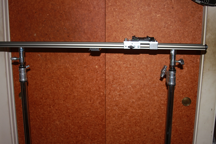

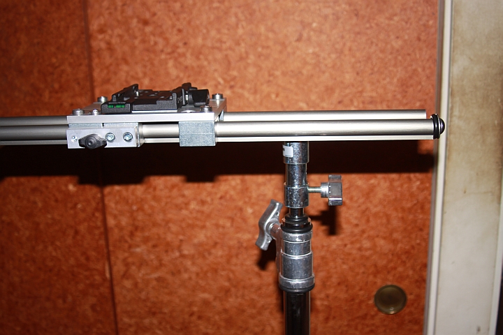

I put two Junior Pins with Baby Sockets on each end of the Igus. This way I can use Junior, Baby or C-stands to support the slider. Since I have stands that can go from around 3 inches to 22 feet in height, I can support it at any height needed. My junior stands have a lazy or mountain legs so I can level front and back as well as side-to-side. C-stands with sliding legs also allow for setting up on uneven terrain.
The sawhorse is a great idea however, it has limited adjustment.

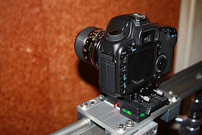

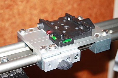

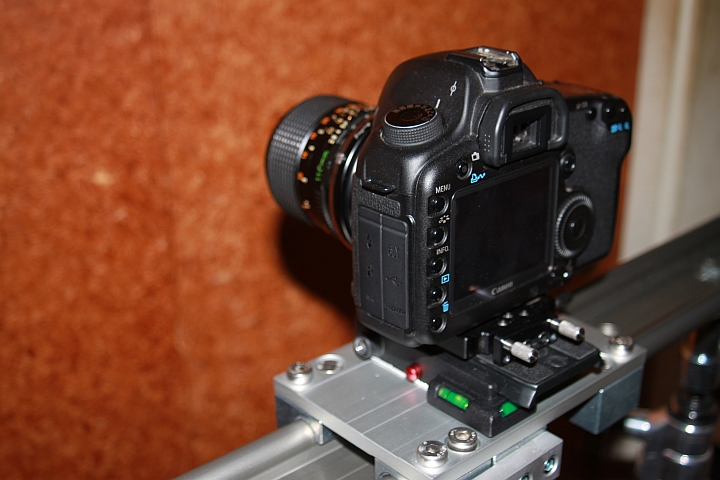

Here ya go fresh from the camera, in this set-up the slider sits a top a couple of Gary Colmans.

From Igus on Amazon the $207 version then added the Junior pins and quick change adapter theaded the ends and added the carriage stops,

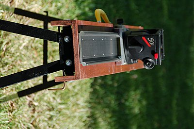

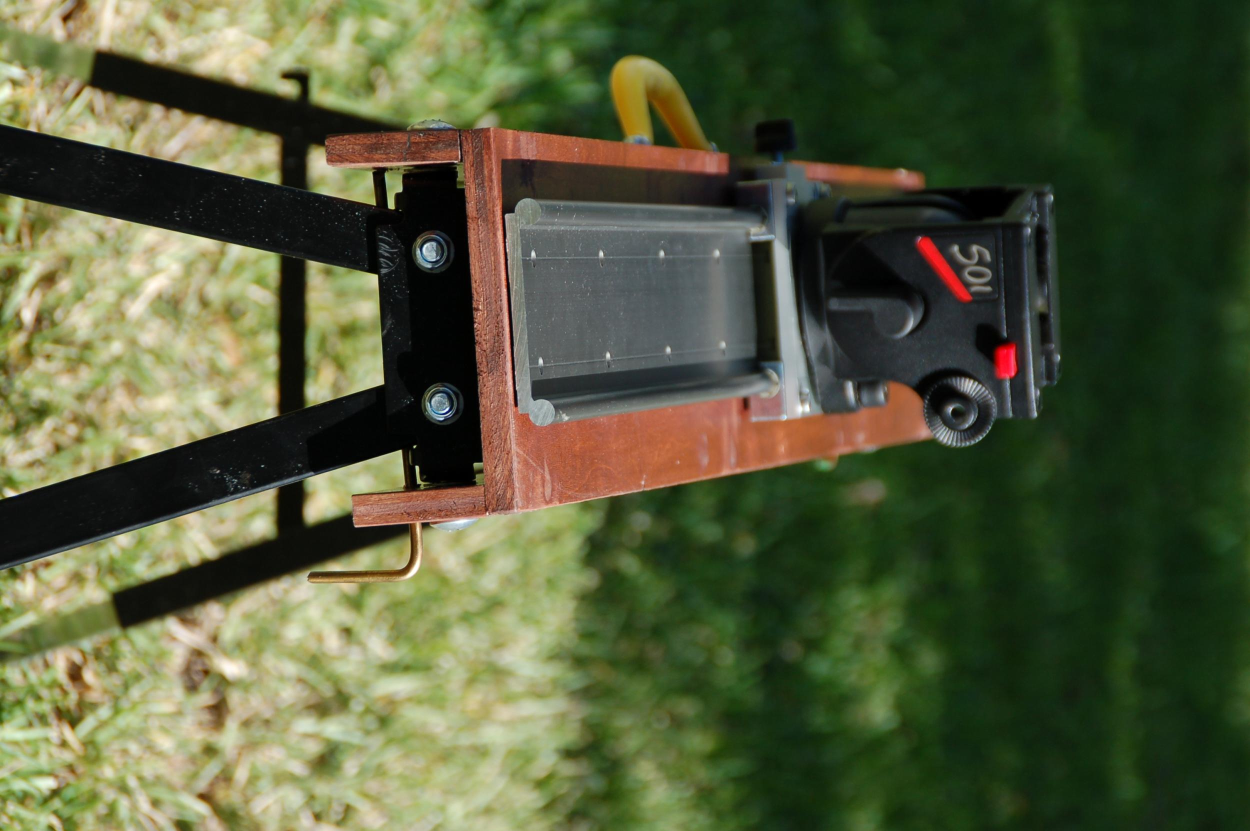

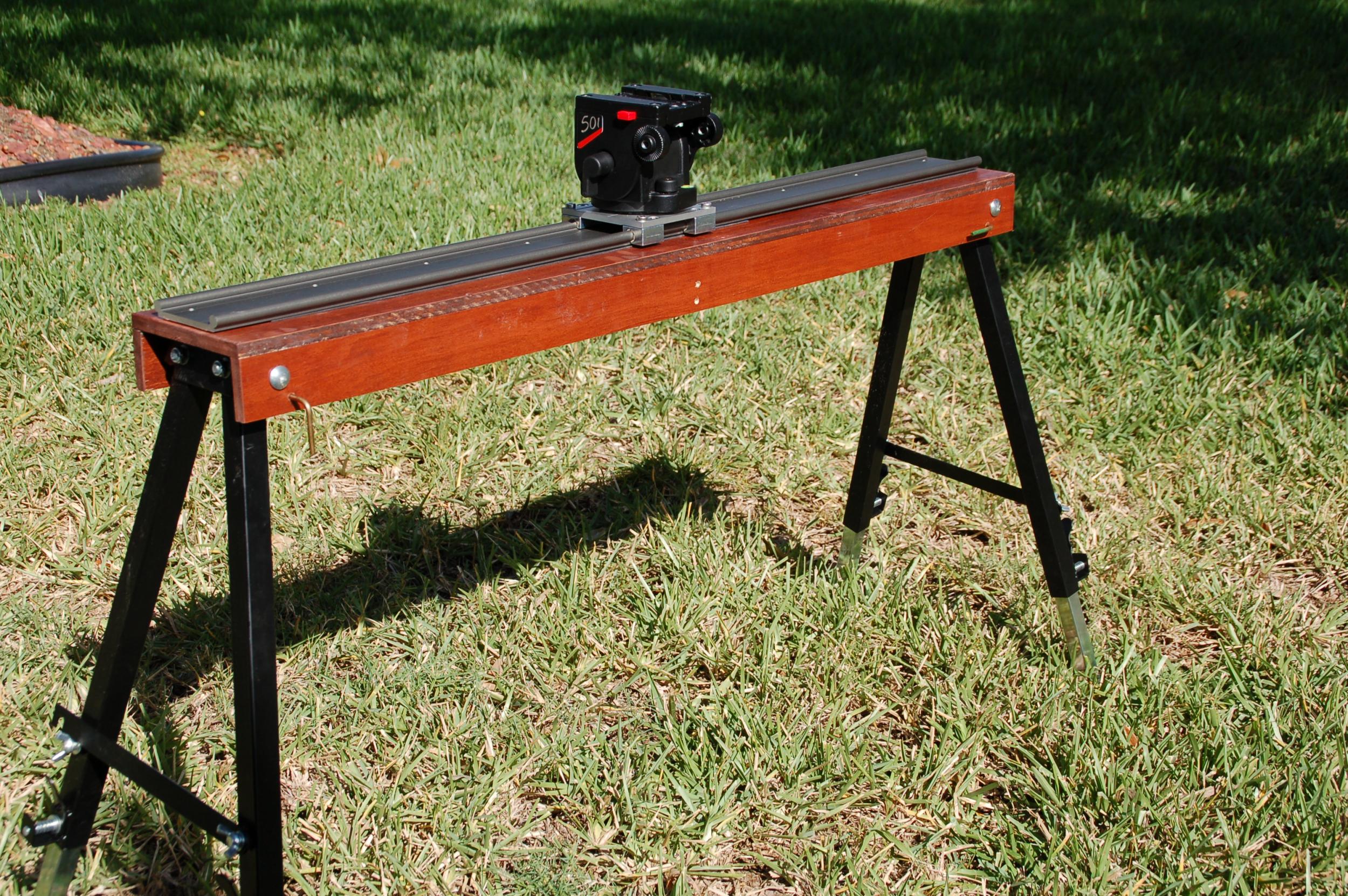

Well here is my take. I took the sawhorse apart and used the legs and handle. Had a friend make the channel out of wood and stained the wood. There is a little more tweaking to be done. Let me know what you think.
Dan

Bill, thats a pretty neat solution. Nice job. Dan, How much lighter does the wood replacement make it. I'm wondering if you could just attach the legs directly to the bottom of the Igus.

Steve it took about 5lb off. you would have to make a bracket to make the legs fit.
