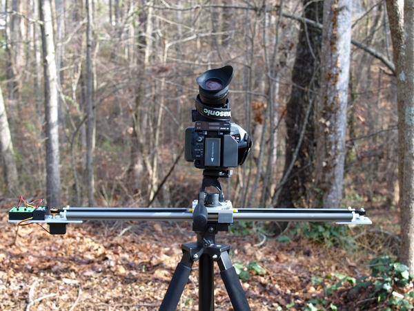

I have my 28" Igus slider mounted to a Manfrotto 577 quick release which is attached to a Davis & Sanford ATP All Terrain Tripod without Head approx. $125.00. It has a 35 lbs load capacity. I also use it with my jib.
