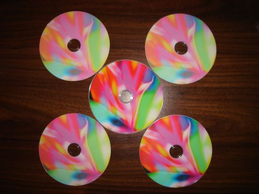

I have 5 discs, coasters left over from a previous experiment. the one in the center is untouched sample (small speck on upper left was a spot on the disc before I printed). The upper left disc was removed from the printer the moment it finished printing, and was ran under hot water, while I rubbed hard. upper right disc, was same water and rubbing, one hour after printing. lower left disc, 24 hours after printing. the lower right disc was taken directly from printer, and rubbed very hard with a paper towel. there are tell-tale scuff marks on the latter. all discs are ritek ridata hub printable, printed using the epson printer. I figure my cost at about 50 cents per disc, including ink. water definitely affects the color of the discs, but normal handling has not yet caused me a noticeable problem. I always stack them immediately after printing, with no sticking. this thread made me curious as to how my discs held up, so I performed my self test :)

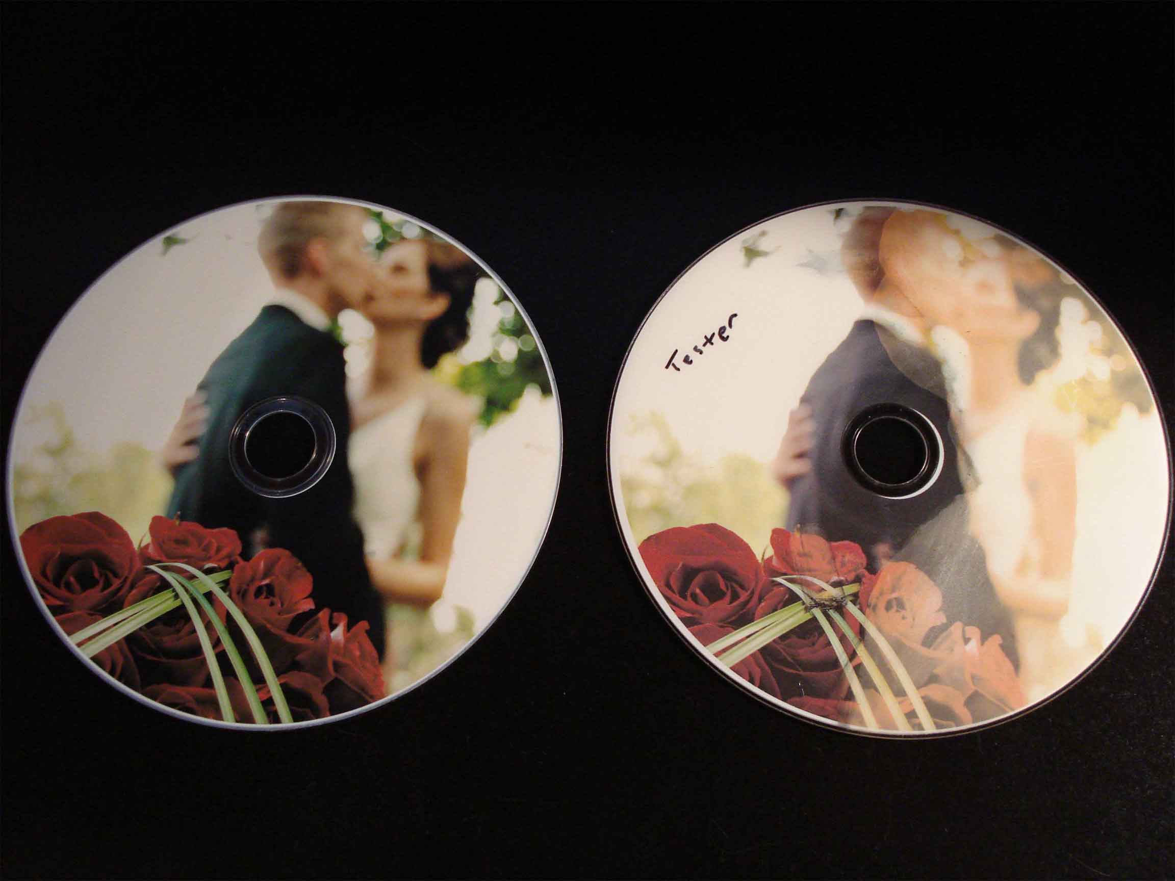

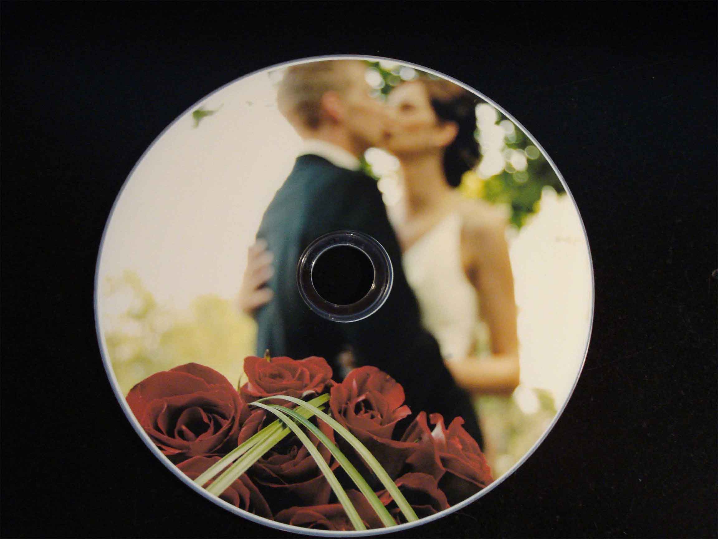

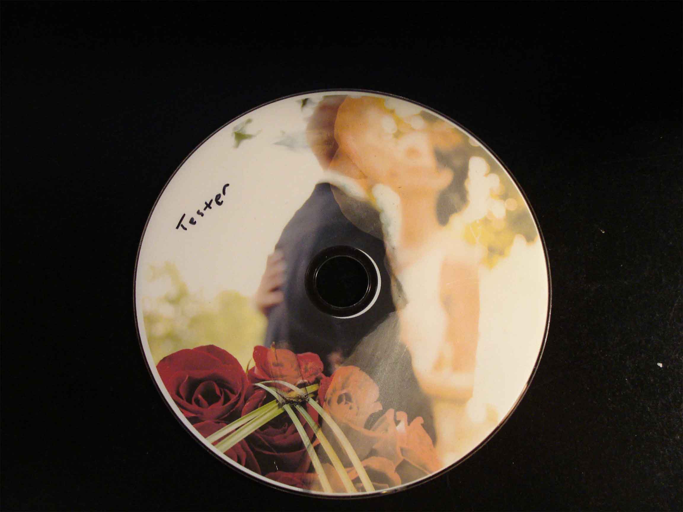

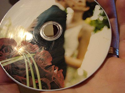

So here are the results....
The pic with two side by side are the Watershield on the left, with the memorex on the right, both after testing.
Just the watershield was rubbed with a dry paper towel, run under the tap, patted dry and rubbed dry. No ink removed, scuffing occurred.
Just the Memorex: The right half was run under the tap, half the ink came off. The bottom right quarter was patted dry, more ink came off, then the same bottom right quarter was rubbed dry which made even more ink come off. At the center of the bottom, I wet my finger and ran it along once... leaving a nice smear. The ink also scratches off easily.
The Watershield held at certain angles, the scuffs can be seen. To the neaked eye, they are a lot more apparent.
The vivid print quality of the watershield really doesn't show through in these pictures. Trust me, it is 1000 times better. The glossy really makes them pop. And besides that, they are -R. Best all around in my books.
