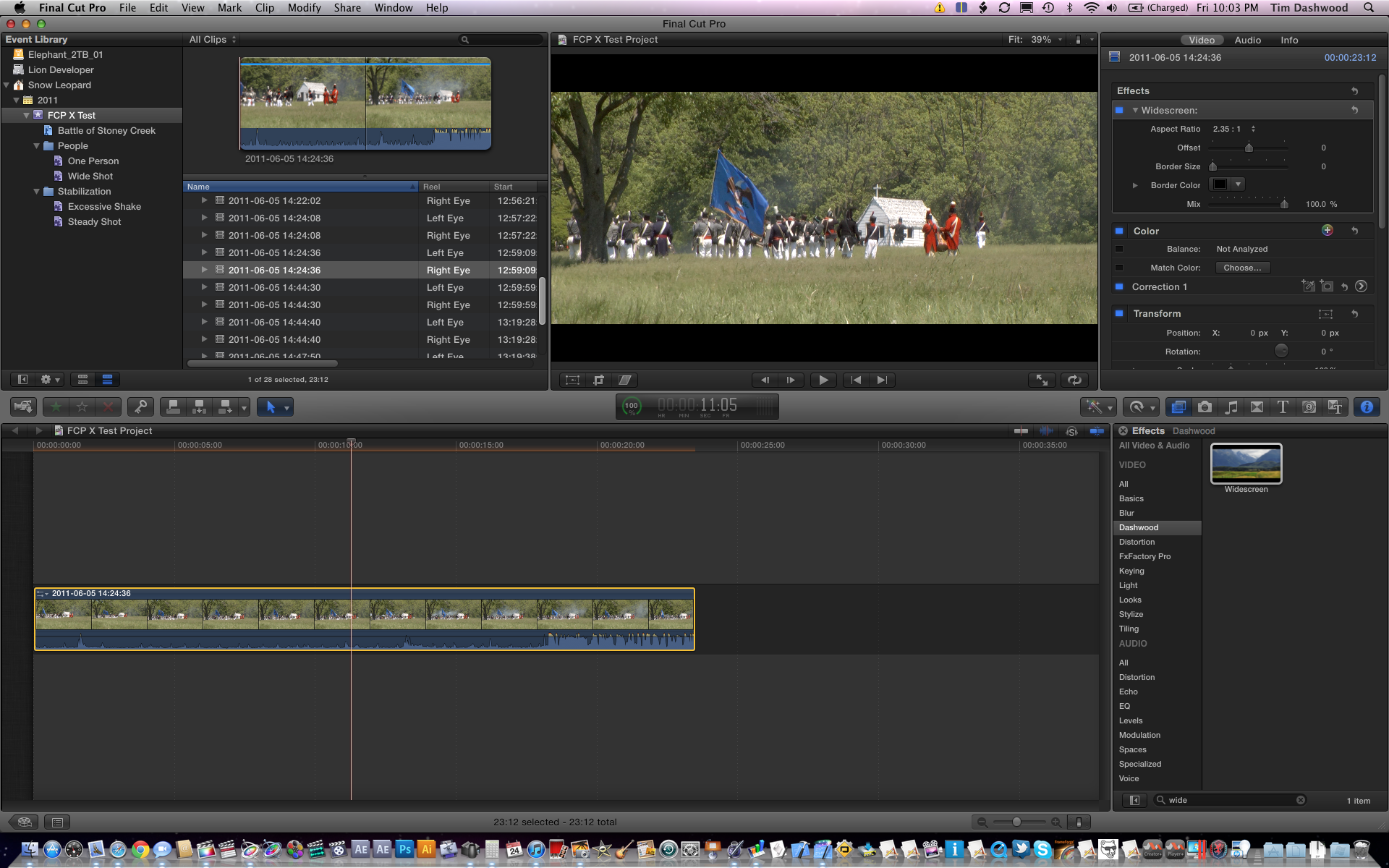

I made an effect template for you that works exactly like the Widescreen filter in previous versions of FCP with Offset, Border Size, Border Color and Opacity.
Just unzip it and drop into your ...Movies/Motion Templates/Effects folder and it will show up in effects when you search for "widescreen."
I've attached a screen grab as well so you can see how it should look.

Tim you are a wizard! Thanks so much for that it works great! I don't know how the hell you did it, but big props to ya!
