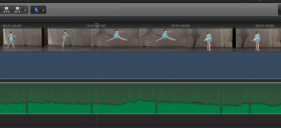

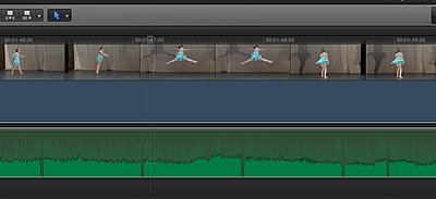

Im getting this, (see pic)
The gaps in the audio are mostly about 20 frames apart, but not always. They roll off rather than being straight cuts. It is sometimes unnoticeable when listening, but once you know its there......

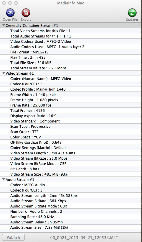

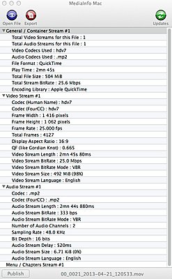

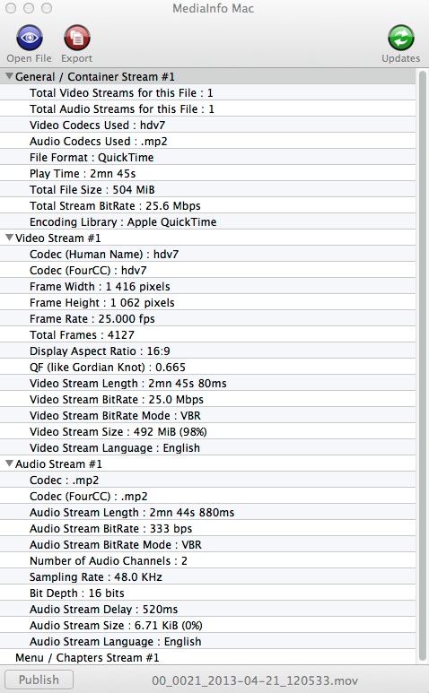

Media info for both the m2t and the rewrap (see pics)

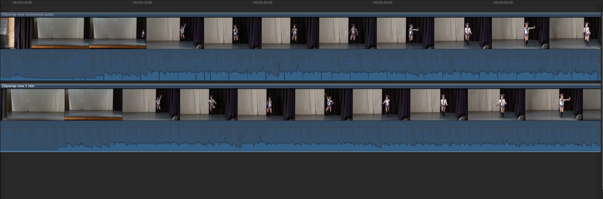

When doing this, all is ok with the audio, (weird though, it actually changes the duration of the clip, might be an issue if multi cam. See pic, same clip in same place on timeline with the 2 different audio options. Thats a problem for another day.....)
You called it William. Thanks.
