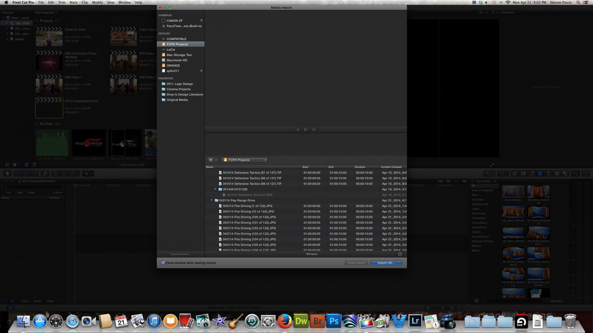

No import of mxf files after Canon utility.
So, working on my iMac and Macbook Pro, It appears that after the Canon utility merges the files, FCPX won't import them anymore. Even drag and drop doesn't work. I can still use them in PC/based Vegas, but I'm not sure if it's a folder structure issue.
Has anyone else been able to import mxf files into FCPX after merging them with the Canon utility?
For what it's worth, below is the response from Canon about the issue. I know I posted in the Canon forum, so if an admin wants to delete that one, I think this might be a better place for the discussion.

No import of mxf files after Canon utility.-screen-shot-2014-04-21-9.02.39-pm.jpg

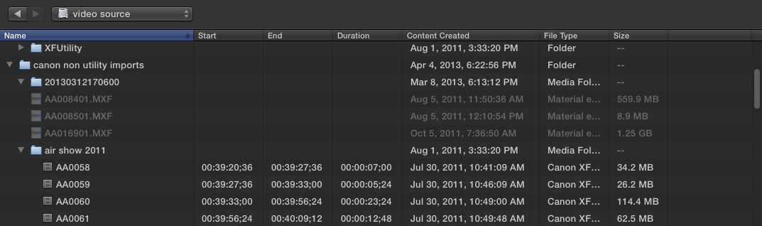

Here is a screenshot of my media import window in fcpx. You can see that files included in the " canon non utility imports" folder are grayed out. This is so because the files were not properly imported into the Canon utility. I had loaded these files onto my MacBook Air using a card reader, and then tried to move them onto my Mac Pro for editing. Everything went fine except the Canon utility refused to import them and fcpx does likewise. Could you have somehow corrupted the finicky Canon import process by moving files around or adding another folder in the mix?
No import of mxf files after Canon utility.-screen-shot-2014-04-25-8.30.25-pm.png

Steven, I tried the merge utility as you did and fcpx will not import the file. It is greyed out just as you experienced. Must be a Canon thing?

OK, that explains things. The problem doesn't lie with XF Utility's .mxf exports - FCPX will not import ANY "bare" .mxf files. It will only import .mxf if they are housed in a full, complete card structure (whether on a card or a volume on a drive). I think the card structure is also required for .mts (AVCHD) files, but ClipWrap will re-wrap those if you don't have the entire card structure. However, ClipWrap doesn't work on .mxf.
I wouldn't expect Canon or Apple to ever do anything about this. They already offer a simple, fast, excellent import workflow that they would not see as needing fixing. You are simply adding an extra step (that is really just a personal preference) that breaks the workflow.
To me, your approach of merging a bunch of clips into one long one for editing is an unusual one. I find shorter clips easier to manage and organize. Yes, you can keyword small selections, but if you're really using the power of FCPX keywording it works better on smaller clips. And the longer the project, the more the use of keywords will save time and searching. But, that's your business.
I don't know of a way to make a merged clip look to FCPX like a card volume, so I think the best approach would be to convert the merged clip to ProRes, which CAN be imported without a card structure. Those conversion apps recommended earlier in the thread are generally terrible - they degrade the quality and often introduce audio sync issues. Here's the best thing I've found - Davinci Resolve Lite. Seems crazy, but it's free, and will import "bare" .mxf and export to ProRes which FCPX will import without a card structure. To me it would be a pain, but this is one option where your use of just 1 or 2 long clips would be an advantage. Resolve is not the most intuitive thing to figure out, but a bit of web searching will show you all you need to know to do this. You just need import/export knowledge, not color grading :-) I did just export and merge two files from XF Utility, imported into Resolve, then exported as ProRes, so I can verify that it works.
I do wish that FCPX would import more file formats without the accompanying card structure.
