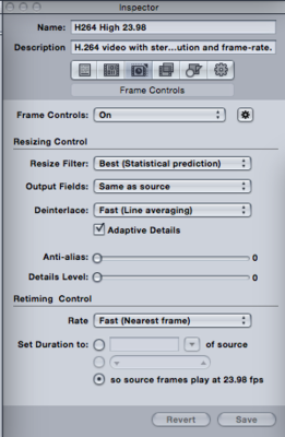

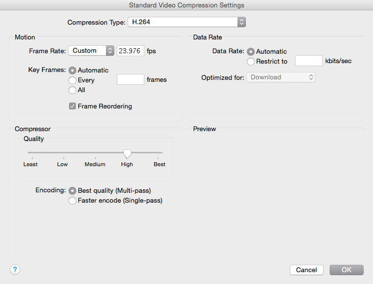

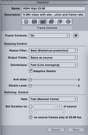

so without an alternate suggestion, I just did it in Compressor. It more time consuming than doing it in Final Cut because I have run my source files through Compressor and retime them at 23.98 so not the best option, but it gets the jobs done otherwise.
If anybody else goes this route make sure you change the RETIMING CONTROL to "So source plays @ 23.98". I also, based on suggested changed RESIZING CONTROL to "Best" instead of "Better". Also in the video settings changed framerate to 23.976
