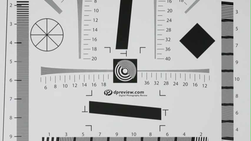

Sorry it took so long, but I wanted to post some samples of what I'm seeing. I put a high res test chart ("fair use" borrowed from dpreview.com) on an HD timeline, and then exported to SD resolution via 2 different methods: via Compressor to DVD MPEG2, or via Quicktime Conversion to DV Stream.
The Quicktime Conversion is what a good downconvert should look like. On the other hand, the Compressor downconvert is an ugly mess. It might be a little harder to tell in a still frame, but it is glaringly obvious in a moving picture. Look at how the vertical resolution test (left column of horizontal lines) turns to a smear, and look at the stairstepping and aliasing visible on the "wheel" pattern in the upper left. In a moving picture, the quality problem is 100x more obvious.
Note that the difference is not due to MPEG2 compression, it is due to the terrible downsampling done by Compressor. If you feed the QT Conv. DV file into Compressor, you get a great MPEG2 file with none of these problems (but you lose potential quality due to the DV compression artifacts and 4:1:1 color sampling).

Terrible results HDV 60i to SD, 30/24p ok, any ideas?-hd-sd-test-via-compressor.png   Terrible results HDV 60i to SD, 30/24p ok, any ideas?-hd-sd-test-via-qt-conv-dv.png
