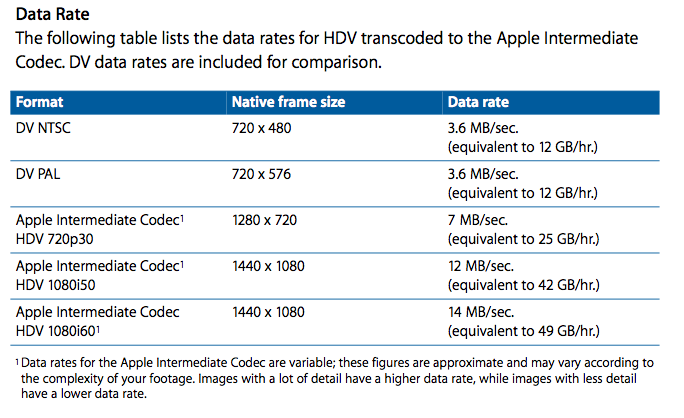

When using AIC (Apple Intermediate Codec) at 1080/60i, the data rate is around 14MB/second (112Mb/second) which is much higher than HDV. The AIC is intended for editing, so it uses a higher data rate.
