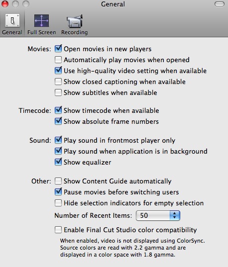

No doubt, it is weird behavior but the fix is easy. In your prefs for QT you'll note a checkbox at the bottom that enables color-matching to FCP; turn this on and things will look better.

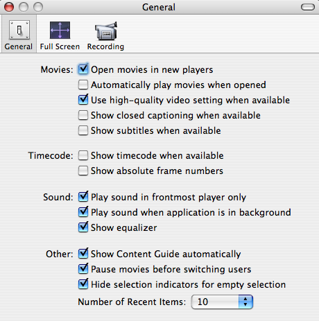

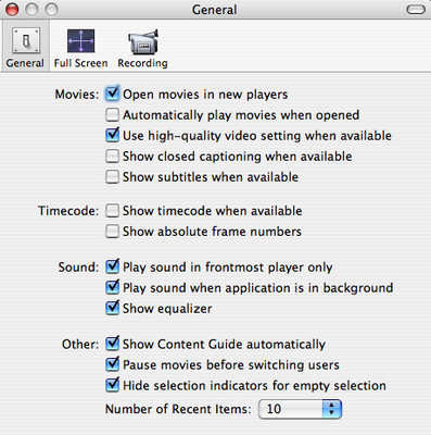

^^ By the way - is that a recent amendment to QT? I don't seem to have that option on 7.4.5...little wary of updating Qt at the moment also.
David Scattergood is offline   Reply With Quote
You'll find it in QT 7.4 in QuickTime Player>Preferences... or by hitting 'cmd ,'
I feel a little neglected here Liam...it's a hiding from me?!?

Originally Posted by Mark Keck View Post
If memory serves me, you must have FCP6 installed to get this option
^^ That will explain it - i have version 5.
Cheers Mark.
Cheers Mark.
Sorry David, bowled you a wrongen' there!
Have a look in System Preferences, I seem to remember an option for color mapping there, though I could be wrong (as proved above).

Robert,
You are a genius. Thanks.
If I am playing a QT file on a computer that does not have FCP will it look washed out?
No probs ol bean. I'll dig around, otherwise I'll stick with adjusting contrast/colour via Movie Props.
When I adjust contrast and aspect ratio I'll save the file (in the same location) keeping the new adjustments permanent. I suspect that the same will apply with colour matching.
