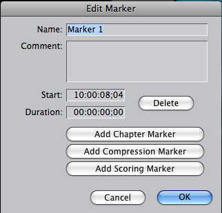

  3. Hit the "M" key a second time and the marker info window will pop up.

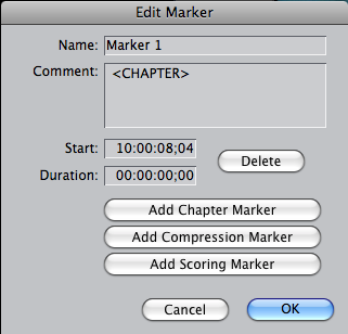

  4. Click the "Add Chapter Marker" button and <CHAPTER> tag will be inserted into the comment section making this readable in DVD authoring programs as a chapter. You can also rename the marker to something other than "Marker 1." Whatever you name it here will show up in the "Scene Selection" menu in your iDVD project.

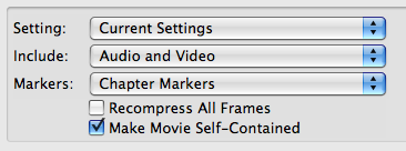

  7. Make sure you are outputting with Chapter Markers and save your Quicktime.

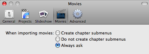

  8. Now open iDVD and set the preferences to "Ask" what to do when it sees a file with chapter markers (you won't always want to make scene selection menus.)
    Attachment 7926
    Attachment 7927
    Attachment 7930
    Attachment 7931
